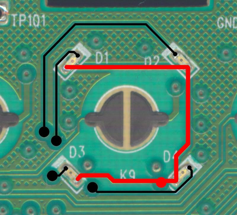

Also is this how the LED should be oriented? Or are my LEDs even fixable? I followed your tutorial and I had success with wiring the LED up like in your tutorial so I think it's totally doable for me if I know where everything is supposed to be. Do I need to fix all the LEDs for any of them to work?
Is this how it should be oriented? The layout for the player 1 LED is really awkward on this board compared to others so if I get that one the rest should be relatively easy.

What you have drawn out for the LEDs there is shorting everything. You need to realize that the nearest Via to a torn up trace doesn't always mean that's where that trace was going, as in the case of those bottom LSC spots. A lot of those are just ground connections that tie the top and bottom ground planes together is all. This is the trace layout for the LEDs in the Wired CL there.

I fixed the LEDs on the controller but I haven't really checked on the rest of the problems with the controller. Would I be able to check the traces with a multimeter? I have like a $5 one, but I'm don't know if it's any good for anything other than checking batteries.. it's this one: http://www.amazon.com/DT830B-Digital-Voltmeter-Ammeter-Multimeter/dp/B005KGCI0Y/ref=sr_1_1?ie=UTF8&qid=1397697330&sr=8-1&keywords=dt830b. I don't know what values I'm looking for or even what mode is used to check continuity.
