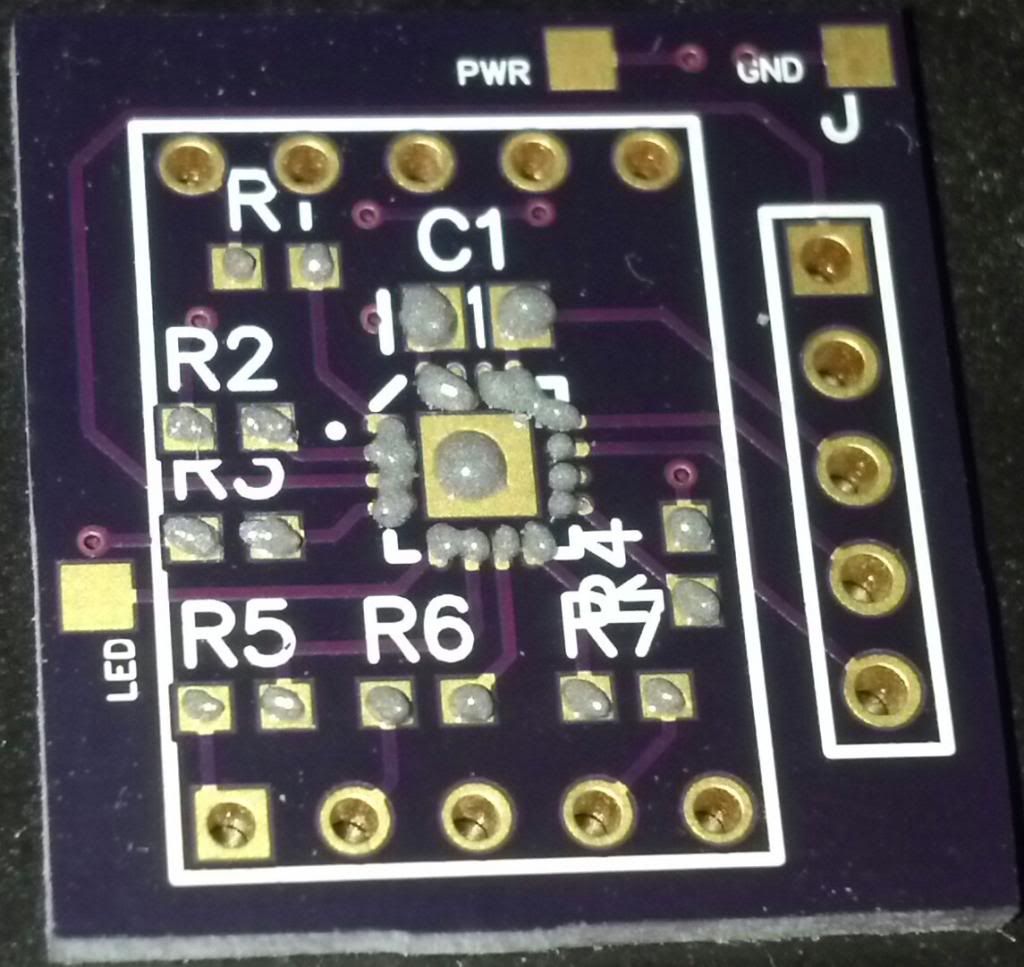

Alright guys, im here with a new project that i started gathering pieces for. Its a solder paste dispenser done through an air compressor attached to a solenoid valve that then connects to a solder paste syringe. At the press of a button, It'll pump anywhere from 30 psi to 50 psi into the syringe pushing the plunger and thus the paste. After releasing the button the the exhaust valve activates and releases the pressure from the syringe.
I found on YouTube that a guy, goes by the name Sparky Widget had done this project already. So all credits and hats off to him!
Mine will be done in a similar fashion except with fewer parts thus cutting cost. Once all parts are in, i will update this as i go along.

i am like a kid at the candy store when it comes to getting my items in the mail. so i filled one of the syringe with my solder paste. the solder paste tube i bought there is an extra for when i run out.
UPDATE2:
Here is a quick snapshot of the result
and here is the video link
http://youtu.be/l32z7jlZlak

Updated and pretty much complete at this point. Nothing but fine tuning from now on. But i will upload a better video.
