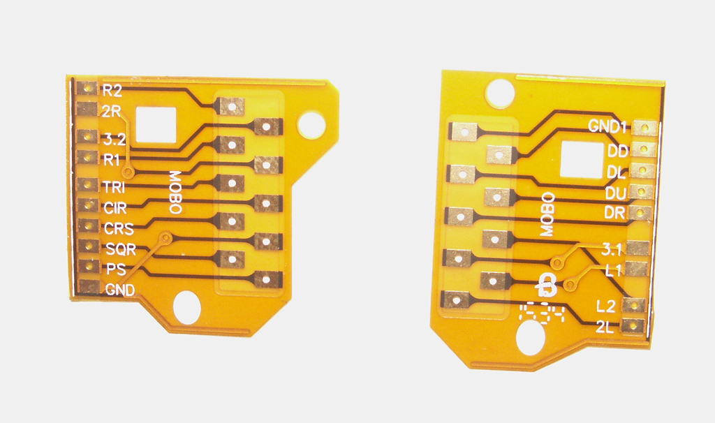

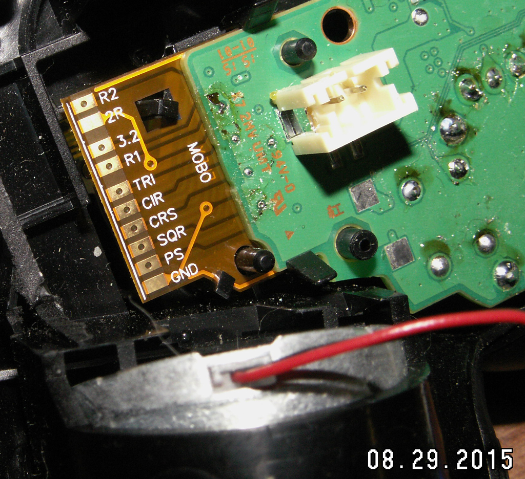

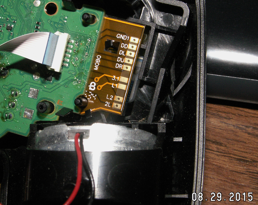

I designed these up a little while back. They are for keeping you from needing to solder onto the PCB of the JDM-030 for duplicating any of the main buttons, but they were also a test for another project that is almost complete now.
Left side
GND1 - Common for D-pad
DD - D-pad Down
DL - D-pad Left
DU - D-pad Up
DR - D-pad Right
3.1 - Common for L1
L1 - L1
L2 - L2
2L - Common for L2
Right side
R2 - R2
2R - Common for R2
3.2v - Common for R2
R1 - R1
TRI - Triangle, /\
CIR - Circle, O
CRS - Cross, X
SQR - Square, [ ]
PS - PS/Home
GND - Common for the 5 above buttons

Hi, would be really interested in a set of these, really impressive. I was going to try and solder direct to the board... Until I saw how tiny the lines were😳. If they're available I would love to buy a set? Also when connected, (I'm assuming they will) will the face buttons work as well as any buttons soldered to the board? Cheers
  • Posts: 2671
Re: JDM-030 Simple Flex for Duplicate Tacts
« Reply #8 on: September 15, 2016, 03:33:50 PM »
They do not change how the controller works at all, they just make the soldering easier, so the face buttons and everything still all function normally.
