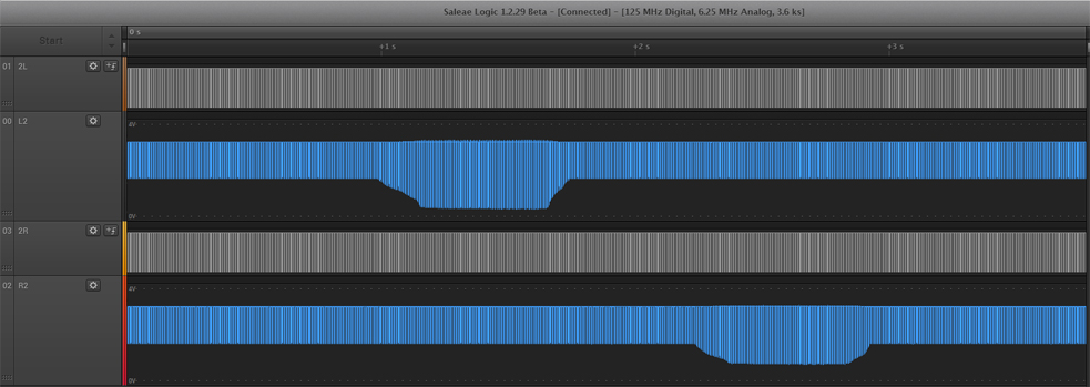

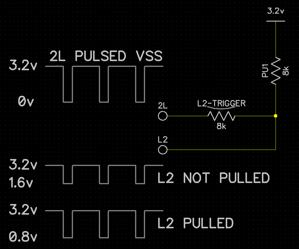

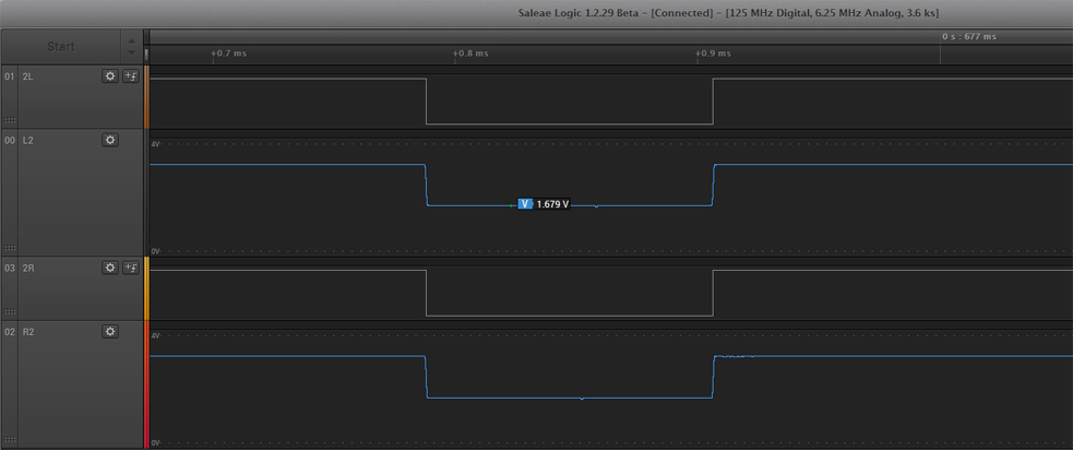

The L2/R2 are a bit of a mess. They use a pulsed VSS that goes into a voltage divider, and it's speed is either 100Hz or 250Hz depending if it's wireless or connected over USB. The ground half of the voltage divider is the L2/R2 button, the more it's pressed the lower the value of that Resistor. The other side of the divider is a fixed value and connected to the 3.2v supply. When L2/R2 is not pulled, and the controller is not reading them, the pulse is Hi, 3.2v, so the divider output is 3.2v. When the controller reads the L2/R2, it pulses the 2L/2R lines Lo for 120us. the pulsed VSS goes thru the Divider and if L2/R2 are not pulled, the output of the divider will measure ~1.6v, if L2/R2 are pulled all the way the divider output will be ~0.8v or so.
Schematic of how L2 works, R2 is the same
L2 and R2 on the Logic Analyzer. L2 Pressed and released, then R2 Pressed and released
L2/R2 close up and Not Pulled
L2/R2 close up and R2 Pulled all the way

If L2/R2 are not pressed, they will each measure ~1.6v
If they are pulled all the way, they will measure ~0.8v
