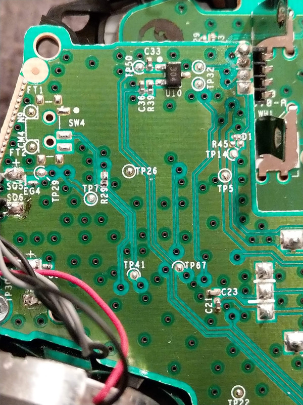

update, grabbed a split damaged donor board to compare with, spotted something quite quickly.....
R29 looks missing, or off its pads, or totally mangled.
what do you think ? bridge ? can I run a link wire elsewhere ? or try and clean then replace with donor cap from damaged board ??
or.....would that not be B button linked solution I was looking for ?
many thanks
« Last Edit: May 22, 2019, 03:51:27 PM by theADDict »

R29 is a 100ohm, 0402 sized, SMT Resistor and is most likely the reason the B buttons is dead as it's in that line. You can jumper it for a test to see if B starts working, but I'd replace the Resistor for a permanent repair if it does work after that.

Tried to clean the area...but was only one pad. Top one.
Tried to replace cap....not got the correct equipment really...or skills.....but then ran a wire from cap...or solder around cap?!...to TP41, so at least I could test.
result.....perfecto.
see how long she lasts.
