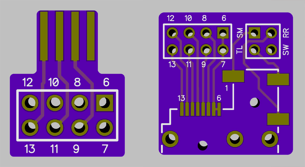

I messed a little with that thing ages ago, never really went anywhere back then and even made up some OSH boards to make poking around with it easier.
No idea how you have pinned it out there number wise, but I did mine like this as it's how they numbered them on the JDM-001 version boards.
Holding the controller normally and looking into the connector.
Code: [Select]
13-11-9-7    <-- Top row
          O  <-- Headset port
12-10-8-6    <-- Bottom row
6 - GND
7 - GND
8 - Detect (10k to 100k PU) This pin is grounded in the Back Button Peripheral
9 - SCL (4.7k PU)
10 - *
11 - SDA (4.7k PU)
12 - External 5v Input, where the charging dock applies 5v
13 - 3.2v
* Pin 10 is Not Connected to anything in the JDM-055. It is connected to the MCU thru a 33ohm on the JDM-001.

The board I made years back was just to plug into the controller, it's not any kind of pass thru adapter that you could tap off, which would also need a connector from a DS4 on it. That's what you'll need if you don't want to do any soldering on that board.
You could make these work. Wire up a 10 conductor IDE cable with a header in the middle to tap the LA onto, but again will need a DS4 Headset connector (SMT version) to install on the one board. Shouldn't be any need to deal with the Headset jack/plug as it's most likely just a pass thru on that device.
EXT Breakout - https://www.acidmods.com/RDC/DS4/DS4-EXT/DS4%20EXT%20Breakout.zip
Headset Breakout - https://www.acidmods.com/RDC/DS4/DS4-EXT/DS4%20Headset%20Breakout.zip

That thing should plug into the EXT port alright, but if it seems too tight you may need to slightly groove the edges of the PCB a little bit, like the actual connector for the Back Button attachment.
