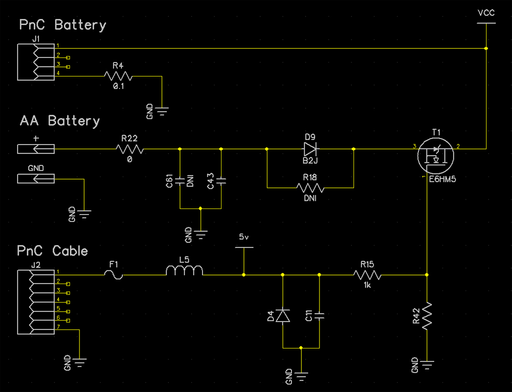

The board is matrix and this controller not turn with battery aa and the cable plug and play. Only battery 4800mah worked.
I tried replace but nothing is change.

The AA - terminal is missing, the AA pack isn't going to work without that. That AA pack also has a switch inside of it that only closes when it's in the shell and it can wear out and need to be bent a little bit to make contact again.
AA + to R22 (0ohm) to D9 to T1, after that it meets the PnC + for that pack which also looks like it's been resoldered and there could be a broken trace there.
The PnC connector looks like it has been changed, so could be broken traces there. Also check F1 (fuse) and L5 make sure neither is open.

Use Ohms, not that Continuity setting, unless you're checking Diodes. I have no idea what 2 points you are measuring there either.
The AA packs can be fixed, or build up that little tab that's in the battery compartment of the shell so it presses on the switch in there more.

« Reply #5 on: February 15, 2020, 12:06:09 PM »
I solder trace terminal battery, now I have to connect it to each other or where?
