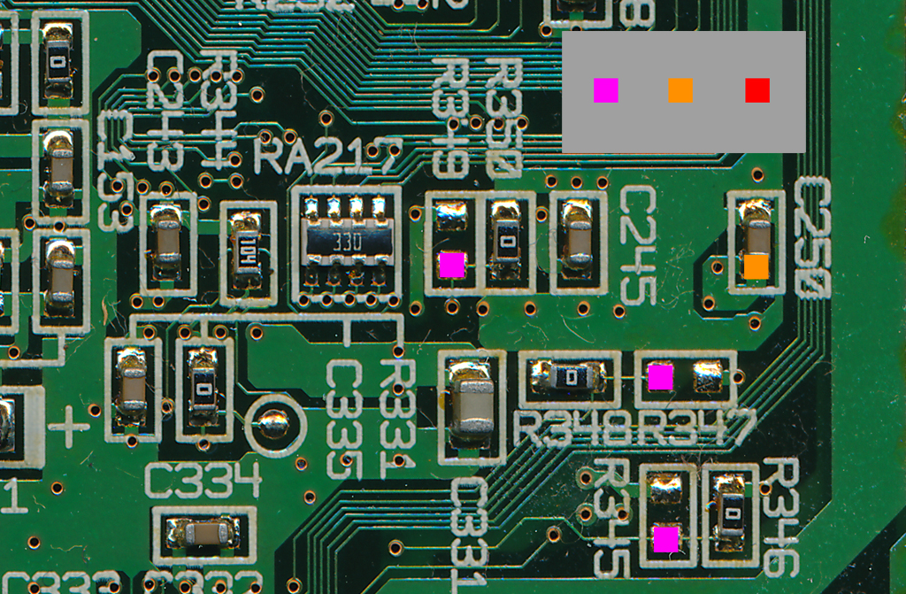

Well that's what I get for going off someone else's diagram and not checking it over first. They only have 2 Resistors installed for the OC, but according to the DS for that clock generator it will take all 3. I just looked thru the DS for that chip, so not sure how they are getting the 36.7MHz as the way they have done it, and the way I redid it up there, that would still be the 33MHz clock, but have a 1% spread versus the stock 0.5% spread. Maybe the chip has internal PU? No idea, point is forget that last post. ;)
So here we go, ignore the mess above as that will only get you the same 33MHz clock +/- 1% or 32.67MHz to 33.33MHz
Technically there are 3 control lines for the clock generator IC, and each one has a place for 2 Resistors in a divider layout, to either tie the control line Hi or Lo, aka 3.3v or Ground.
Control 1 - R345 (Hi), R346 (Lo)
Control 2 - R347 (Hi), R348 (Lo)
Control 3 - R349 (Hi), R350 (Lo)
The stock speed setting is all 3 control lines tied Lo, so R346, R348 and R350 are all populated with 0 ohm jumpers.
In order to get the 36.7MHz, that has a 2% spread or 35.96MHz to 37.43MHz, all 3 control lines need to be tied Hi. So again, forget the above and go about it this way instead.
1 - Remove R346, R348 and R350.
2 - Install 10k 0603 at R346, R348 and R350. Tolerance value doesn't matter.
3 - Here you can just use a SPST switch now, or half of a DPDT, either one.
The way this works now is all 3 control lines are tied together, the violet spots to the switch. They all get set Hi or Lo anyway for the stock or OC setting, so there's no real point in having them all separate as that would require a 3PDT switch, or a DPDT and SPST or 3 SPST switches if you wanted to be able to go thru every clock setting, but they are all 33MHx +/- some small percent, so basically all of them are 33MHz so no point in going thru all that mess.
The switch has 3.3v in the middle, flipped one way the 3.3v goes to the Red spot of the switch, just to light up the stock speed LED as the 10k you swapped in there will keep all 3 of the control lines pulled Lo for the stock speed setting.
Flipping the switch the other way, the 3.3v goes to the violet spots and pulls all 3 control lines Hi for the OC speed. You can also wire up your OC LED to that side of the switch.
Swapping out the original jumpers in step 2, the R346, R348 and R350 for the 10k keeps the control lines pulled Lo if the switch is removed or goes open for some reason, so the stock speed will be the default if that happens or if anyone just removed it and did nothing to the board.
Side note: It should go without saying to never flip this switch while the DC is on, just to put it out there. Best case the thing will just lock up an need to be power cycled, worst case who knows, but no point in risking it.

So just installed the overclock switch and everything is working fine. I want to make sure I'm in the right mode. So if the switch is perpendicular under the  yellow side that's overclock correct? So if its switched over on the violet side that would be stock? From testing it seems to run better when its lines up on the yellow terminal opposed flipped over to where the two violet terminals are.
  • Posts: 2671
Re: Dreamcast overclock switch question.
« Reply #15 on: April 09, 2020, 09:20:35 PM »
Depends on the type of switch you're using. If it's a Slide switch when it's pushed left the middle and left terminals are connected. A Rocker switch will be backwards though, when it's flipped left the middle and right terminals are connected.
So if you're using a rocker switch, and it's flipped toward the Yellow, then you're really in the OC mode and have the middle Orange connected to the Violet.

Here is a pic of how everything is wired up. Based of first post with dpdt switch.
https://s.amsu.ng/1RC81zxFYjHN
The white wire is hot to C250, the black wire is ground off C250, the brown wire is connected to R346 on your yellow diagram. Violet is tied to R348 & R345 then to the lead on the dpdt diagram in your schmatic. Just need to know if flipped over to the violet side if its overclock and if switched to the yellow stock clock speeds. It's a dpdt switch only goes two ways and it's a on/on operation. I already know how to install the OC leds using a 3v 3 pin 5mm bi color led. Wiring that to the switch is a no brainier but my brain has gone into limp mode trying to figure out what switch converts the clock to overclock.
Edit. Wire my switch wrong. I knew the overclock was not aggressive but I figured I'd be able to tell the difference then reviewing my wiring on the switch the violet leads were on the wrong pin. I definitely know what's overclocked and what's not now. Thank u RDC for everything, it truly means a lot to me.
« Last Edit: April 10, 2020, 04:29:30 AM by Brian 503 »
  • Posts: 2671
« Reply #18 on: April 10, 2020, 04:23:15 AM »
That's a toggle switch, same as a rocker where the position it's set is reversed on the wiring terminals.
Imagine this as looking thru the top of the switch.
Code: [Select]
Switch flipped to the Right, terminals in the Middle and Left are connected.
| 1 - 2   3 |
| 4 - 5   6 |
Switch flipped to the Left, terminals in the Middle and Right are connected.
| 1   2 - 3 |
| 4   5 - 6 |
That doesn't look wired up right on the switch to me. One set of the opposing corner terminals should be wire free.
Code: [Select]
Back of switch, held so it Toggles left/right.
| 1   2   3 |
| 4   5   6 |
1 = No Connection
2 = Ground
3 = R346 bottom side
4 = R349 bottom side and R347 left side
5 = 3.3v
6 = No Connection
Toggle Left = 1 & 2 then 4 & 5 are connected, DC is Overclocked 36.7MHz
Toggle Right = 2 & 3 then 4 & 6 are connected, DC is stock 33MHz
Offline Brian 503
