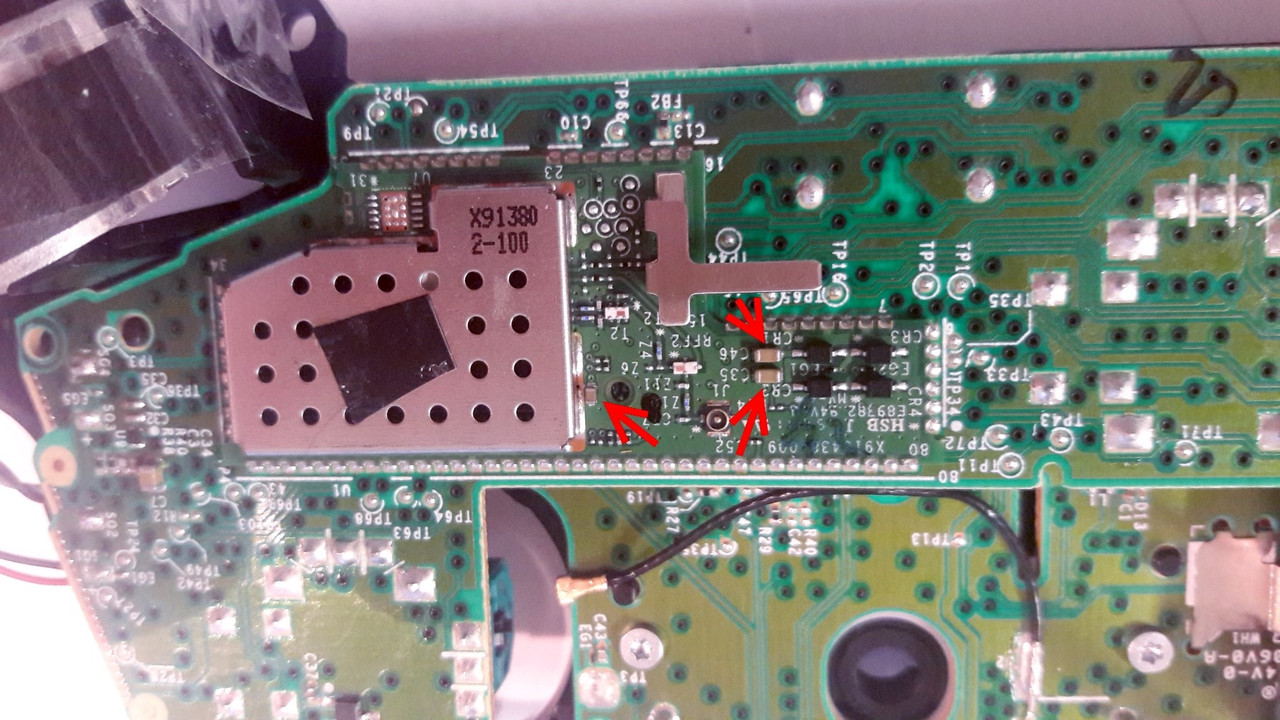

Offline rolnikziom
Re: Xbox one controller 1708 Range issue
« Reply #9 on: May 16, 2023, 10:33:19 PM »
I have this same issue.
I swapped  Z10, Z11, C77, RFF2, Z4, C13, T2, Z2, Z1 from working board and nothing change.
This is strange, because this isn't work only with xbox. When i connect wireless with notebook range is fine.
