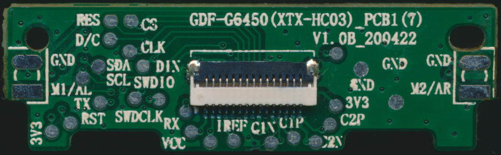

Finally picked one of these up, that didn't cost an arm and a leg and have poked around with it a bit. Will get some better images and such up when I have the time. Suspect now that it's a knockoff compared to the one mrt posted an image of here https://www.acidmods.com/forum/index.php/topic,44569.msg335405.html#msg335405 as well as another one LethalPrime brought to my attention.
Not really a heck of a lot going on in there hardware wise, it's pretty much all firmware that makes it happen.
Interestingly, they seem to have designed it with 4 buttons in mind (this board version anyway) instead of the 2 that other version of the board has. The 2 unpopulated buttons do nothing if they are installed, so I'm sure the firmware just isn't setup for it.
The display is a 128 x 32 OLED, possibly using the SSD1306 driver. I'll know more about that once I get an adapter board made up so I can see what's going on there, but it's pretty much laid out like the typical SPI controlled OLED display of that size using a 15 pin connector.
1 - C2P
2 - C2N
3 - C1P
4 - C1N
5 - 3.2v
6 - GND
7 - 3.2v
8 - CS
9 - RES
10 - D/C
11 - CLK
12 - DIN
13 - IREF
14 - VCOMH
15 - VCC
The interface between the attachment and the controller is I2C (360kHz) and it's a little interesting as it seems to be setup for more data than they are using it for with this attachment.

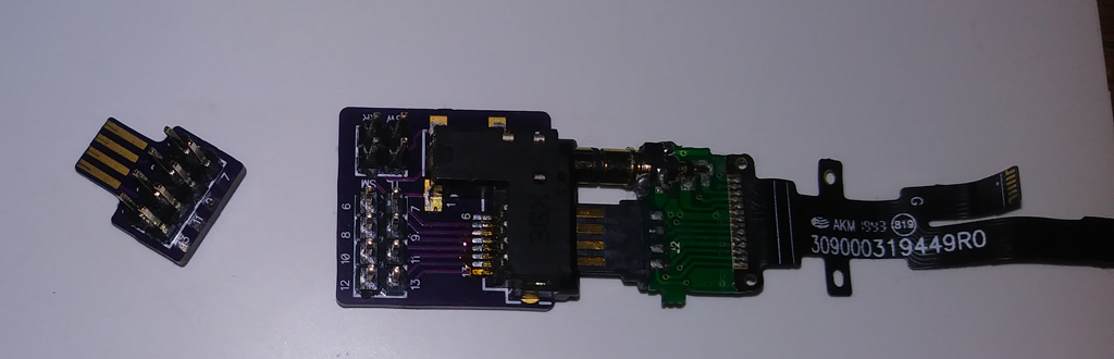

My Schematic* of the 3 boards in there - https://www.acidmods.com/RDC/DS4/CUHJ-15017/CUHJ-15017_v0.1.pdf
*Mostly complete, until I'm done messing with it and can remove everything for checking the missing values as well as PCB layout.

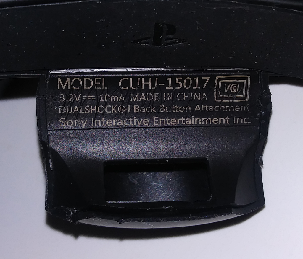

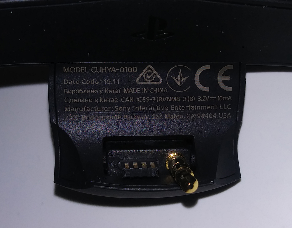

Model numbers and stickers are very different.
OFFICIAL = CUHYA-0100
CLONE = CUHJ-15017

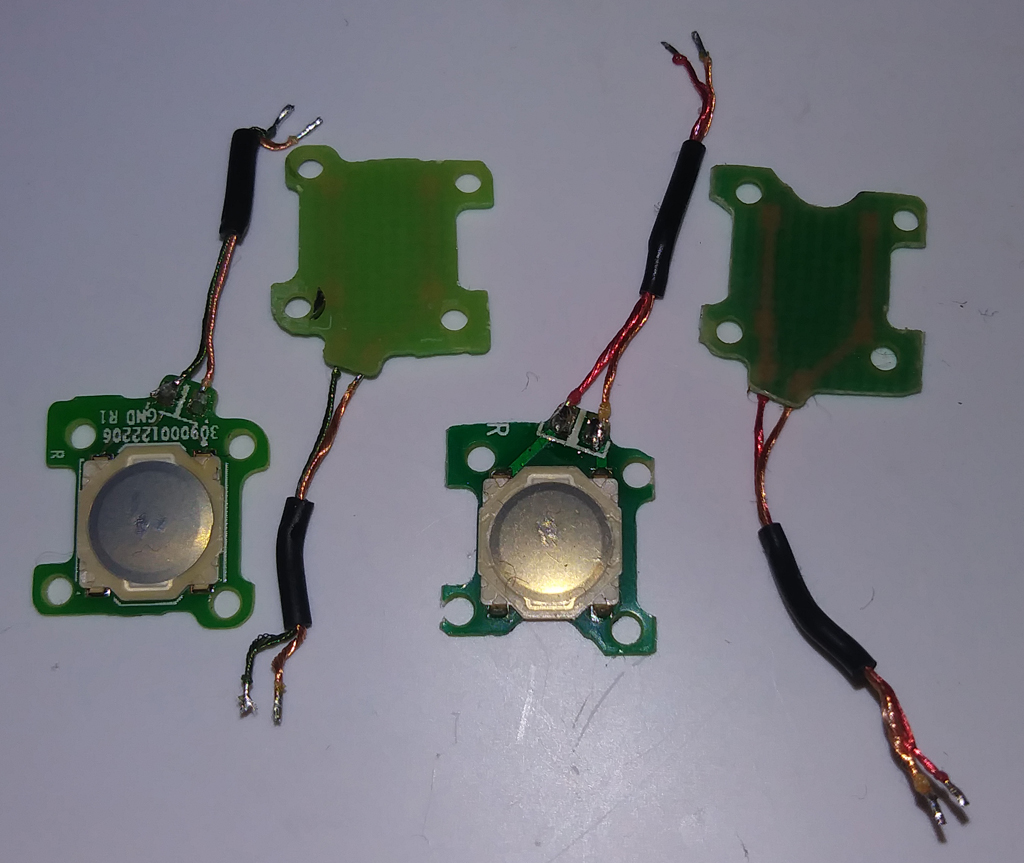

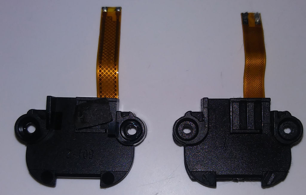

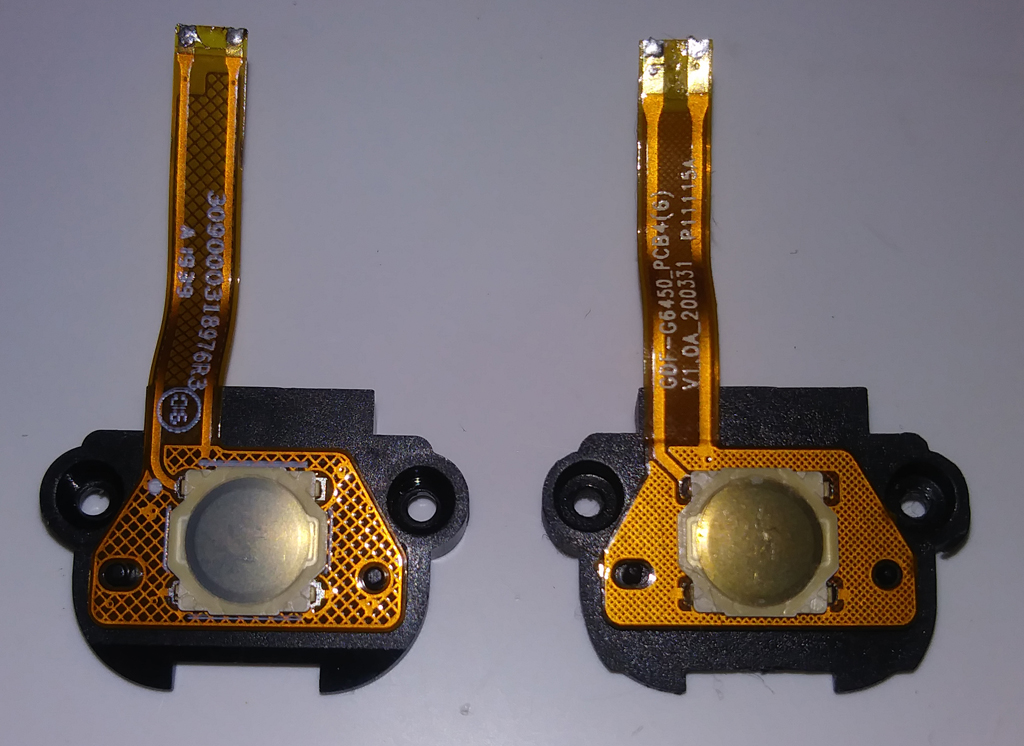

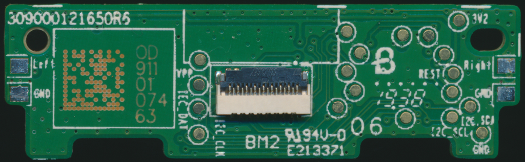

Then we get to the insides, and again it's night and day different. Official one is on the left, Clone is on the right.
LCD Connector is 17 pin on the Official, 15 pin on the Clone

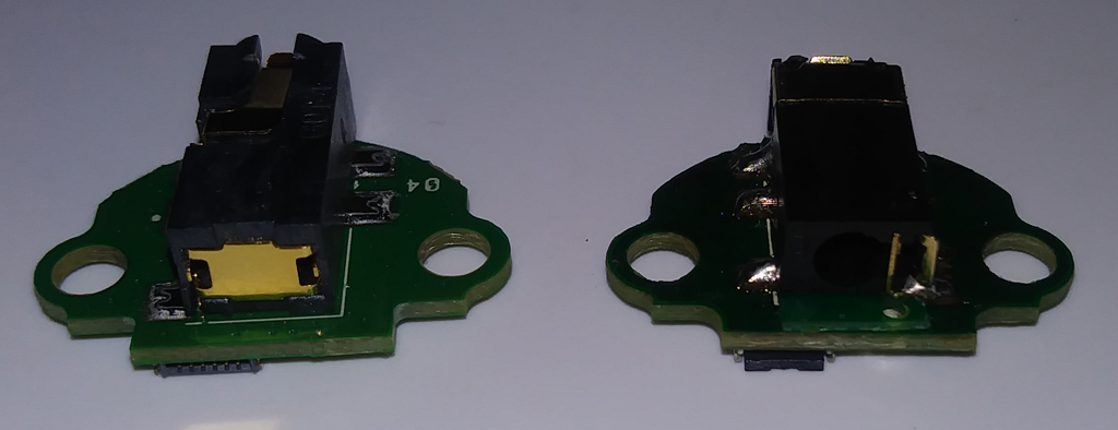

HEADSET Connector Much different. They must not have been able to source the correct one as they had to put a small riser board underneath theirs to make it sit at the same height.
SELECT Button
BUTTONS

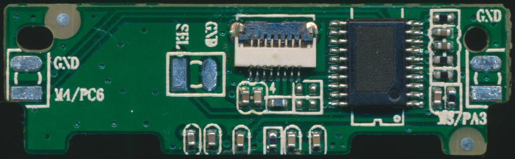

Finally the Motherboard, just again night and day different.
OFFICIAL MOTHERBOARD
CLONE MOTHERBOARD

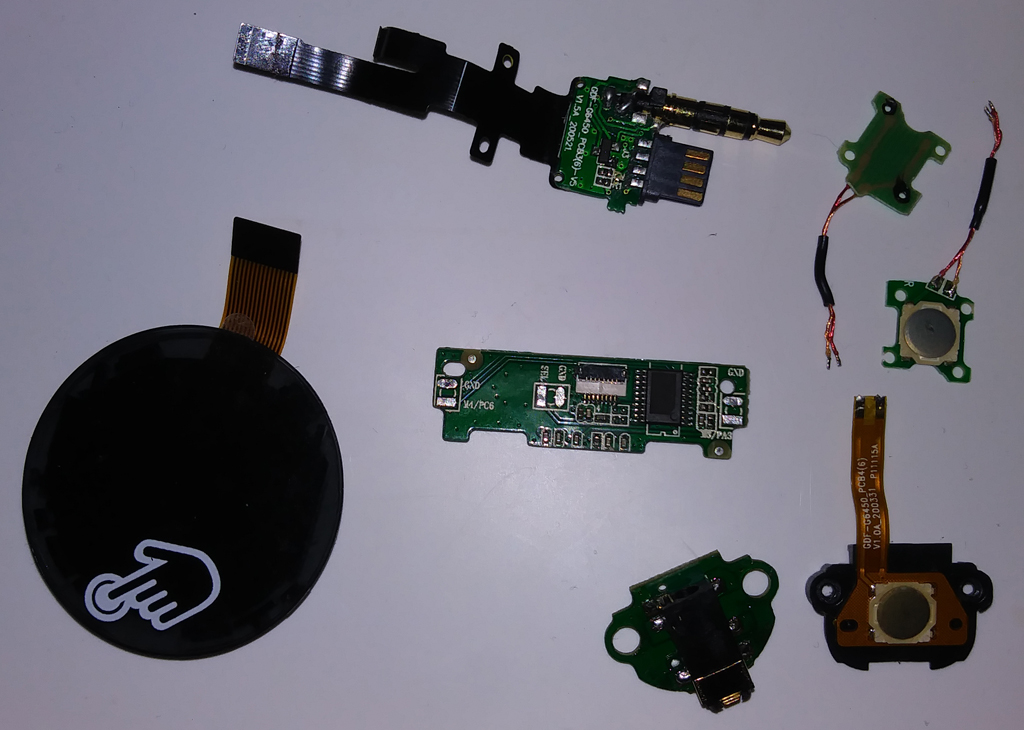

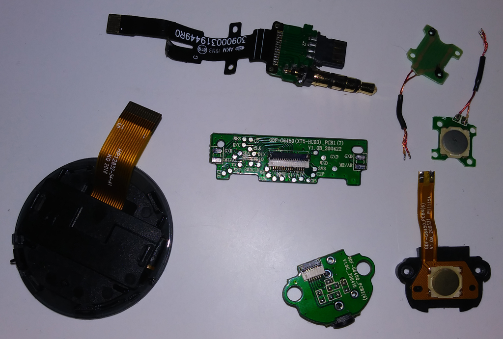

I wasted my money so you don't have to and ordered one of the cheaper china ones just to take a look inside. I have to say you get what you pay for. Only partial advantage of this over the original units is this includes rapidfire OOB and is cheaper, but you really get what you pay for.
The box was generic but not too bad. Can't complain about the packaging.
The fit of it isn't super horrible. It sort of depends on the springiness of the plastic to hold it in the right place. I have to note that the plastic feels VERY cheap. Reminds me of the plastic that is used in cheap screwdriver cases. The plastic tray that holds the screwdriver handle and bits. Definitely not as sturdy feeling as ABS. The buttons are not as clicky as the original ones, and feel mushy. The unit is also thicker overall, and the edges of the back are more square, making it less comfortable to rest your fingers on the buttons.
The connector is a simple PCB. Should work fine but is a bit of a pain to put in the controller.
The fit on the back is almost perfect, but the alignment of the connector isn't - so it hangs off the back a little.
Removing the rubber pad exposes two screw holes in the center. IT also destroys all stickiness of the adhesive rubber. If you care about getting it back together after taking it apart, I'd recommend actually cutting the rubber on either side of the middle section, and perhaps cutting a hole in the middle section for each of the 2 screws, or just scrapping the middle piece of rubber.
After the two screws are removed, the whole thing comes apart. More pieces than i was expecting
The board looks pretty basic. Has what appears to be an P24C02A EEPROM. I tried to read its contents using a CH341A programmer i had laying around, but I just get a block of F's. I don't know if dumping the firmware would be useful to anyone, but If someone wants to help me dump it I'm happy to post it here.
The processor seems to be an innosystem MP01010, but I couldn't find any info on this chip.
Back side of the board only has the buttons and leds. Nothing special
What I'm going to try is build this into the back of a ps4 controller bluetooth keyboard - the kind that fits into the controller. IT also wouldn't be super hard to 3d print and alternate back to this that has more scuf-like paddles.
