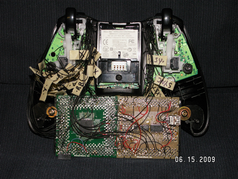

That's pretty much exactly how any Macro controller works, including what I described. The PC or whatever side that controls things is just for setup. The one I worked on had 5 slots. One person could do it, but that person would have to be proficient at the hardware, firmware and software levels and is either going to charge you an arm and a leg, so then using that kind of controller might be warranted, or they have absolutely nothing at all better to do with their time and money and want the challenge of it.
You can line up as much as you want, but then you'll find out that it's not going to be near enough, especially not having any idea what the hardware will be like. Then you start letting feature creep get in there and it'll never get done or blow up into a real nightmare that no one wants to finish and then no one else will touch to complete it because it's so far down the rabbit hole you'd disappear if you jumped in.
It took 2 of us around a half a year a decade ago to do the CGnome for the 360, which would basically be semi easy to pull off on that controller now that we have basically months of experience doing just that one and worked out most of the issues already as well as a decade more of learning other things along the way. Viking had one for the 360 as well that was very software driven and I'd all but guarantee you that he would tell you that thing cost him a pile to develop as well.

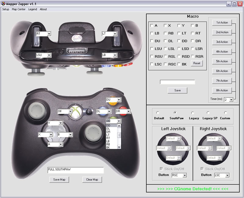

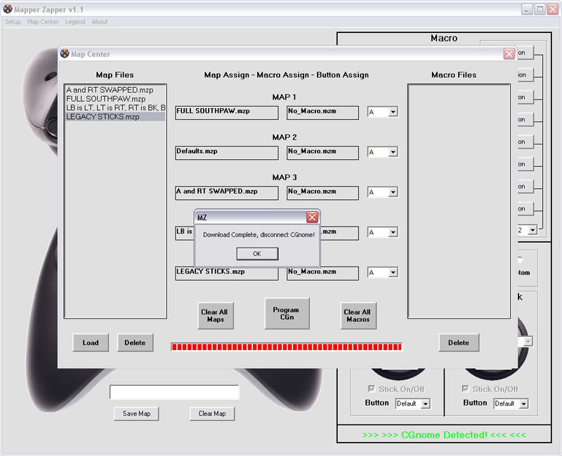

Time, life, other projects and naturally the cost, we did it all ourselves back then as mainly a challenge, it wasn't for mass production and it never caught on anyway. Also the fact that it was a massive bear to install, so there are only 2 or 3 of them in existence, and 1 of them just sits here now.
That level of interfacing with the controller is a right chore since every input had to be severed to get between them and the existing MCU in there. For more of a straight Macro only controller like the Viking one was you can just tap onto all of the input lines in there and end up only needing half as many connections, but that type of controller can't do full remapping like that CGnome could. The Macro side of the CGnome was lacking but it was tossed in as an afterthought since it was designed from the start to just be pretty much 100% a remappable type of controller. You could make Right Stick Up be the X button, LT as DL, DL as DU, every button is RT, all kinds of stupid could be done on that thing as everything but Guide, Start and Sync were remappable. Then tapping Sync cycled it thru the 5 different maps it had with a 6th one being a fixed stock setup, so it could be configured as technically 6 different controllers in one.
https://www.acidmods.com/RDC/360/CGnome/6_map_load.mov
