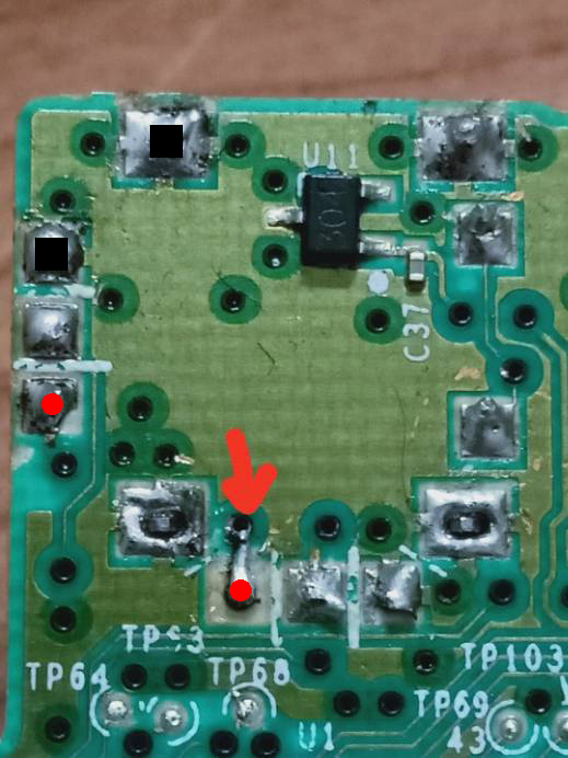

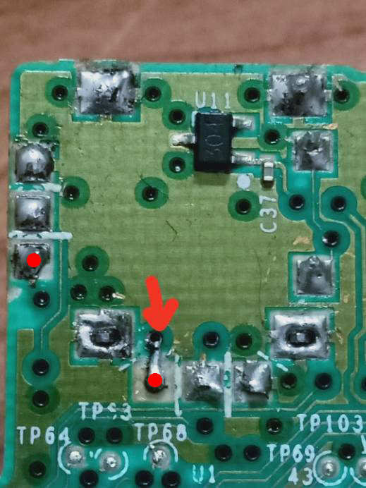

Hello
I changed the left analog to a new one and when I installed it the line indicated by the arrow was separated. Then I connected it to the hole in front of it .. and now the analog gives commands forward and backward only and does not give a command above or below
please help me

you did nothing wrong exept buying :censored: replacement thumbstick

u mean left/right ? if so, solder wire from damaged thruhole to lowest hole of up/down stick.

Jumper wire the spots with the Red dots together, then try it. If it still doesn't work, leave that jumper wire on there and then run another jumper wire from one of the Red spots to TP103.

« Reply #5 on: November 21, 2020, 04:48:28 AM »
thank you for reply mester RDC
When I connect a wire between the two points, the controller does not power up at all

« Reply #7 on: November 21, 2020, 04:59:07 AM »
and are this the 103 you mentioned?
still up and down, not working . i mean LSY

That wire is a bit on the large side, you should be using a 30awg Kynar wire. That wire will work, but take care or it will tear off that TP spot.
If LSY is stuck Down, then the ground connection there could open. Jumper the 2 Black spots together.
If LSY is stuck Up, then move on, you can do better and don't need the hassle, also means the 1.8v is not getting to it and that wiring should have restored that, or there is some other issue on there shorting the Wiper (center pin) to ground.
If the controller is not turning on after doing that, then first undo it and check again.

« Reply #10 on: November 21, 2020, 08:56:12 AM »
thanks for reply
LSY is not stuck up or down . it does not respond at all
analog responds back and forth
but it does not responds up or down

Put a jumper wire from the center pin, the one between the Black and Red spots of the LSY POT, to TP63.
this is TP63

this is TP63
Thank you very much mester RDC you are a legend  :clap:
The controller now works very well  :tup:
