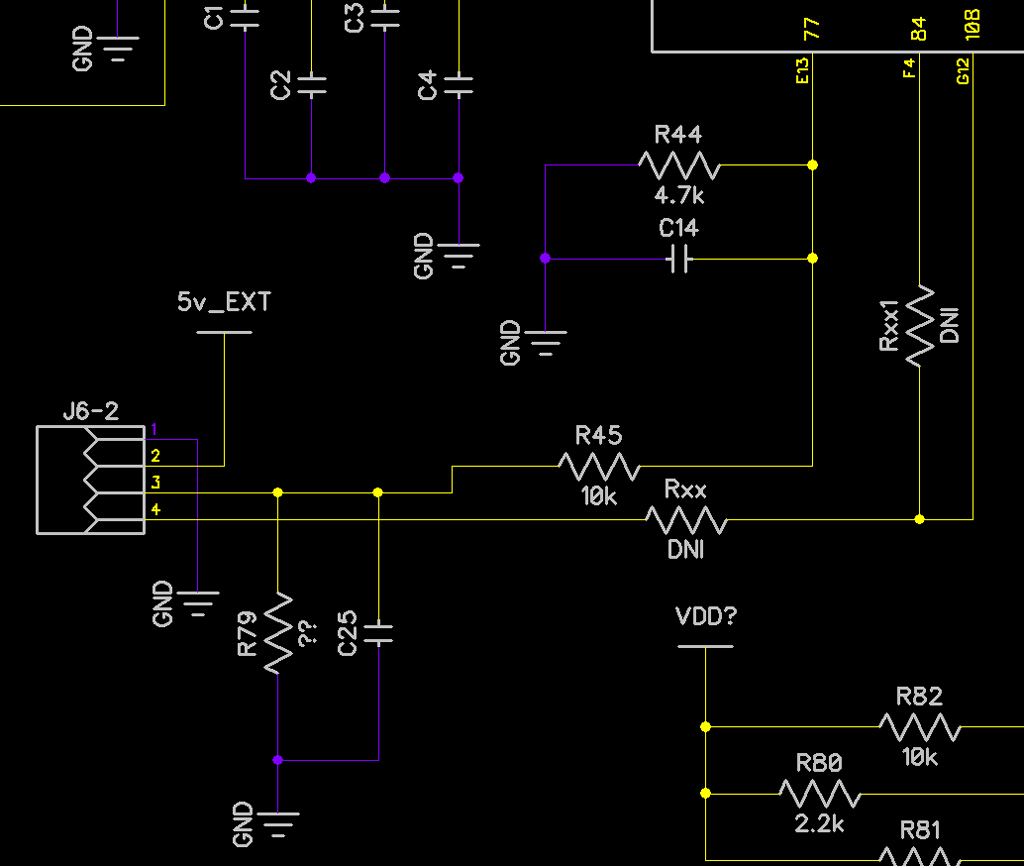

If you have some deja vous I don't blame you, I asked the same thing for ps4 controllers. I'm wondering what the name of the connector on the bottom of the ps5 controller is, so i can order some. I know the ps4 controller used the same proprietary port of an old sony discman, I'm hoping this connector is easier to get a hold of.
I'm wondering if a pinout for it has been worked out yet.

Not much going on there physically. Looking at the connector the way the controller is normally held, Ground, External 5v, and a single who knows yet line, then the last one isn't used at all. No PS5 or peripherals here to see if it's some kind of single communication line or just some active hi detection line.

Ahh alright. So really I just need the left two pins if i wanted to charge it from that port. I read somewhere that it was simple usb 2.0, but the schematic snippet you provided doesn't really reflect that so I'll assume they were just making assumptions. RDC are you making a schematic of the dualsense? OR did you find one somewhere?

I don't have a charging dock to tear up and see if it's doing anything else on that connector, so it could only need the 5v and ground there to charge.
I made the core of the schematic a couple of months ago now, 6 layer PCB, fun.
There is for sure no USB, or any kind of 2 wire communication, going on that EXT port there.
No idea what that connector is specifically called, as it's pretty much designed to the shape of the controller there so I doubt there are any off the shelf mates floating around for it. Just use some pogo pins and make your own.
