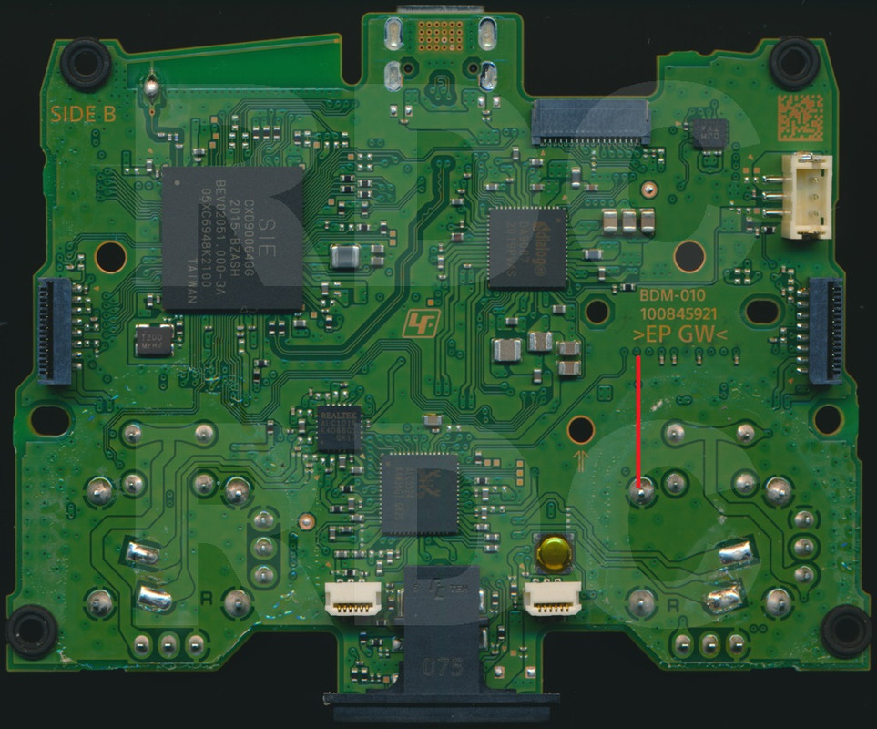

Today I tried a new conductive film, which works, but it didn't solve the problem. So it must be something else.
So you mean, I should just ground X with a jumper wire like this? And so should X button work?
  • Posts: 2642
Re: Dualsense BDM-010 X button issue
« Reply #7 on: July 20, 2022, 07:12:21 AM »
You will need to remove the solder mask form the via there first, but yes, doing that is the same as pressing the X button.

« Reply #9 on: July 22, 2022, 06:42:23 AM »
So I did it, and it works that way. What now? What do you think I should do next?
As I wrote, I have already replaced the conductive film with one that works in another controller, but that did not solve the problem.
Thanks in advance for your advice!
  • Posts: 2642
« Reply #10 on: July 22, 2022, 07:53:39 AM »
All that's left is the connection on the other side of the board where it mates to the Flex. It could be that X contact has a higher resistance than the rest, or that one didn't form right, there's no pic of the other side there to see if anything there looks wonky. One trick you might try, that has also worked on the DS4 controllers as they have the same setup, is there is a small piece of foam under the Flex contacts where it mates to the board. That's there to keep a little bit of pressure on those contacts. You can 'shim' that with a piece of paper underneath it, so the foam then puts a little more pressure on the contacts when it's all put back together. Might work, might not, but you're now getting int the territory of everything is checking out good, but it's not working, and without that kind of problem in hand it's a bit harder to tell what might be causing it without being able to poke and prod to see how it acts.
