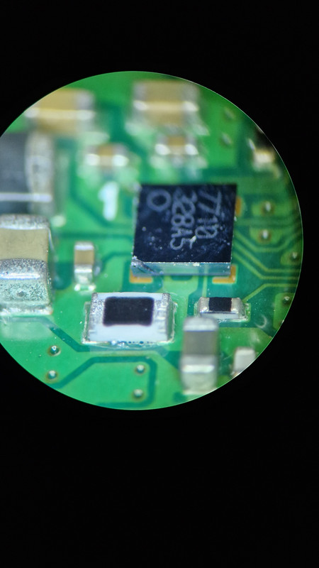

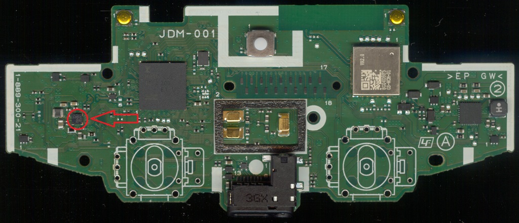

Hi everyone
I have a JDM-001 only it doesn't charge the battery. Only works on usb cable. Shows that it is charging but not charging the battery.
I saw a broken component. JDM-011 cannot see the battery.
Please identify the damaged component
Does anyone know what this is for?

« Reply #1 on: November 01, 2022, 02:54:30 AM »
Search the forum here for TC7710.

« Reply #2 on: November 01, 2022, 09:52:25 AM »
Thank you. I made a search and found it
