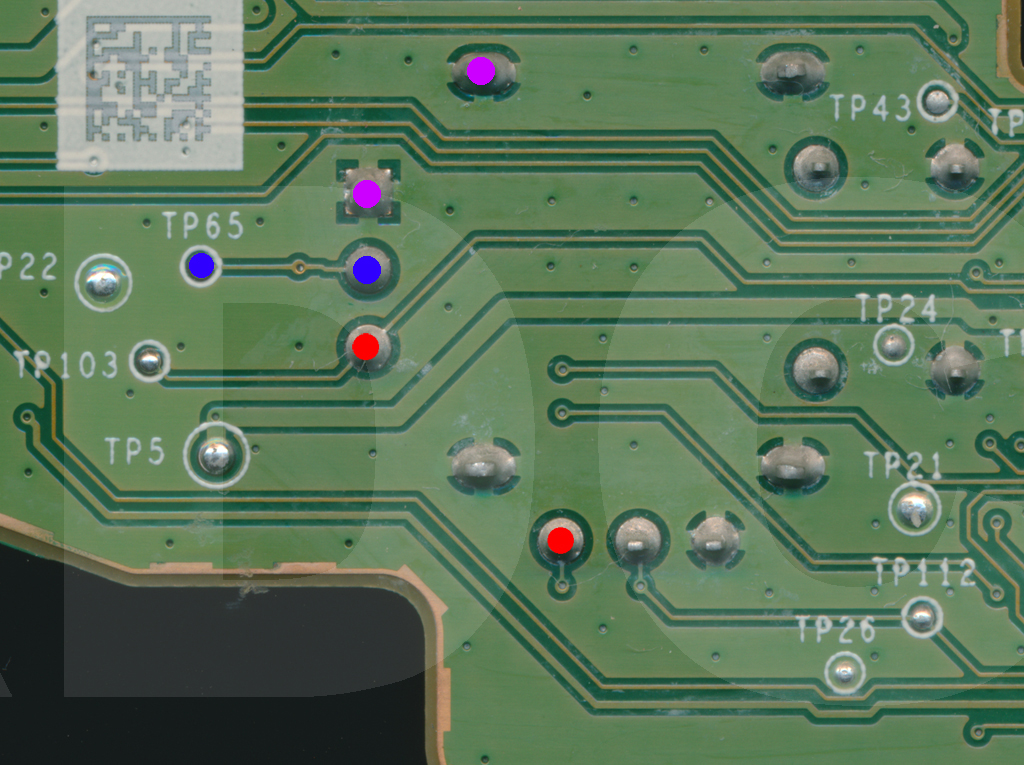

Hello. I replaced the analog in the pad and the right knob all the time up. I know it looks bad but it can be fixed. Might have a short circuit.

« Reply #1 on: March 30, 2023, 02:33:14 AM »
Solder in a jumper wire to connect the two red dots and retest.

« Reply #5 on: March 31, 2023, 03:45:01 AM »
A full tilt forward is no power to the Potentiometer, which doing the red jumper wire should have corrected. The only other thing that can do a full tilt forward is the middle pin (blue in the above image now) shorted to ground.
If the middle pin is open it could go anywhere. Try connecting the blue dots now and retest.

« Reply #6 on: March 31, 2023, 04:18:35 AM »
the blue pins are connected. pink too. I checked with a multimeter.

« Reply #7 on: March 31, 2023, 04:28:36 AM »
With a multimeter on what setting? The Continuity setting is not the best one to use as that will still beep at low ohm values, and that's not what you're looking for. Use Ohms, then also check the value between blue/violet.
Could also be that C23 (top side) is damaged and causing the RSY line to 'leak' to ground.

« Reply #8 on: March 31, 2023, 04:38:55 AM »
between blue and purple is 04.2ohm.

« Reply #9 on: March 31, 2023, 04:53:29 AM »
That's pretty close to a short, but not directly, unless your test leads have that much resistance in them? Also make sure you're not pushing on the stick at all while testing, they should be at the center resting position.
I'd check the test leads first, just short them together and see what they measure, if they are 1 ohm or less, then I'd remove C23 and test blue/violet again.
