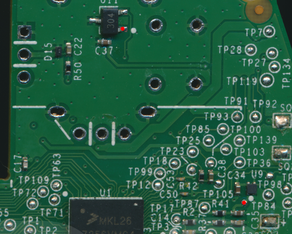

  • Posts: 2640
Re: controller repair not going well
« Reply #11 on: May 03, 2023, 11:00:23 AM »
What voltages are on the 3 pins of U10/U11?

  • Posts: 2640
« Reply #15 on: May 03, 2023, 12:00:01 PM »
Connect the red dots with a jumper wire and see if LT works.

  • Posts: 2640
« Reply #17 on: May 03, 2023, 12:21:15 PM »
You have a 3.3v issue then. Test the top board alone, plugged in with USB cable, and make sure it outputs 3.3v first.

all controler is ok now, i change left analogic but a new,, he had broken traces, i use your jump schematic, now its  the problem is only LT and RT are 100% pressed. Maybe when i  separating the mcu something broke, LT RT are normal berofe this. :cry2:
  • Posts: 2640
« Reply #19 on: May 03, 2023, 12:59:07 PM »
Pin 4 of U9 is supposed to be 3.3v, the top/left pin in the pic I posted. If U9 was bad pulling the 3.3v line down to 1.6v, then all of the 3.3v in the controller would be 1.6v You could try jumpering the top of C34 to 3.3v and see what happens, but I'd want to know where that 1.6v is coming from.

« Reply #21 on: May 04, 2023, 04:19:17 AM »
i found the problem bro! :rofl:
broken track or rust underneath C34,  now i have 3,26v on u10 and u11 , LT RT are normal.
i removed it, scratched and soldered a bridge c34 to u9, now i need way to solder a c34 again without damaging the bridge.
