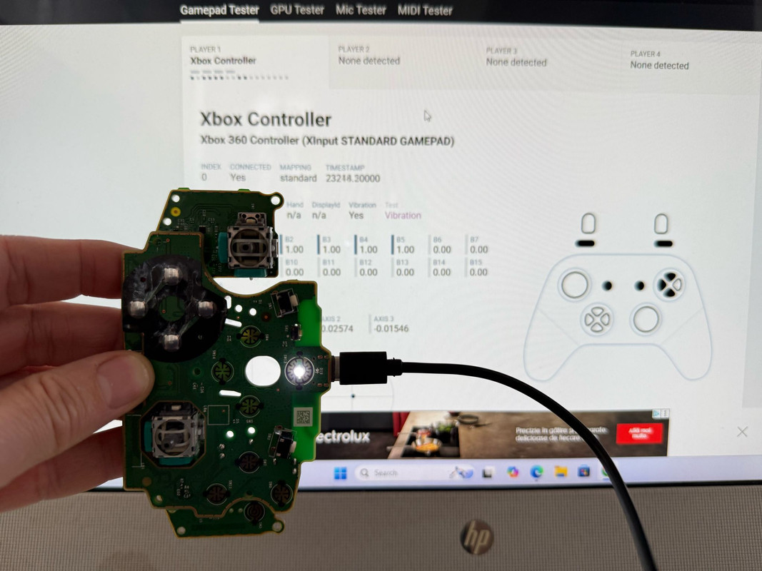

Hi, I have a bdm-40 controller replaced thumbsticks now the right stick is constantly up and left. Does not look like the traces are damaged, I don?t have a scope but too the naked eye it does not look damaged. I?ve read through all the posts and see people have had the same issues on different model boards and put jumper wires on. Could anyone point me in the right direction for the bdm40 version please.
I will attach some pictures of my controller.
I have a second controller which is also a bdm 40 and the create button was always pressed I changed it and it worked for a couple of mins then constantly presses again if I could fix one out of 2 that would be good if both can be fixed that would be awesome!  Any help is appreciated

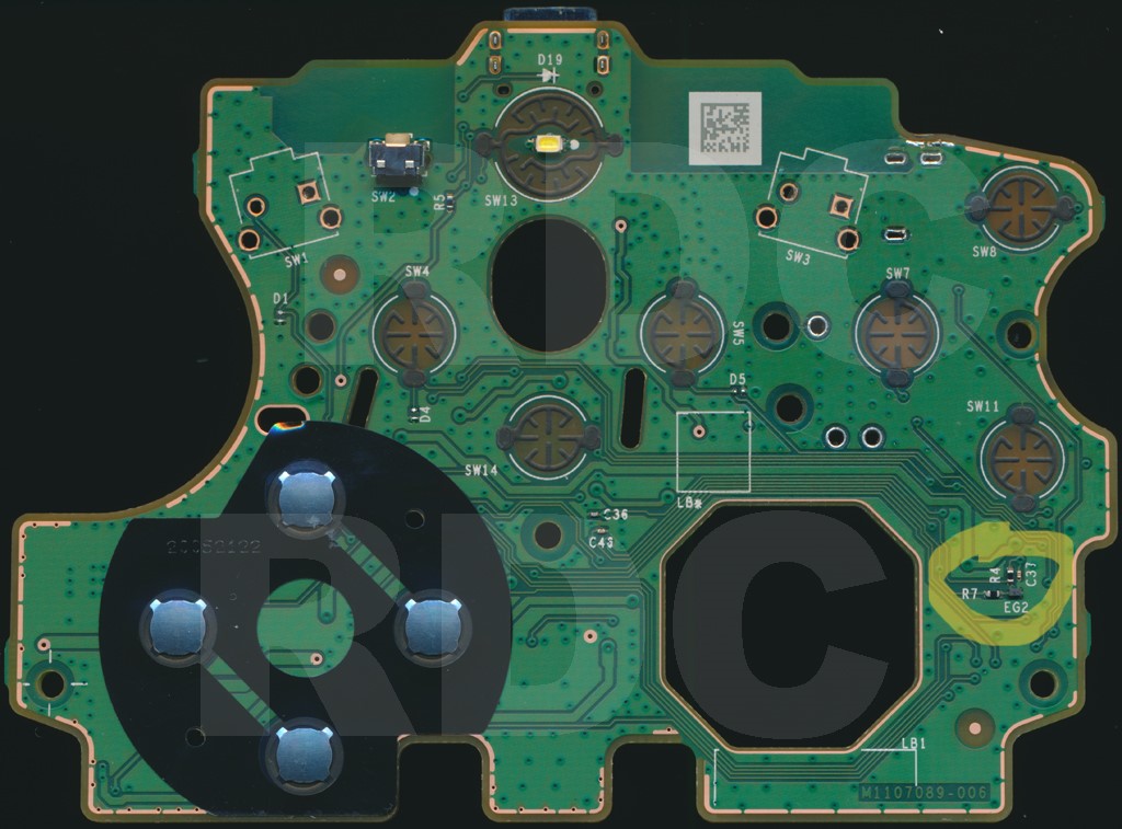

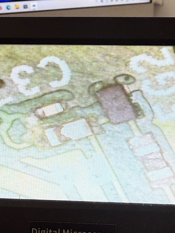

PS4 / JDM-011 controller wont turn on after battery cables shorted
« Last post by sidgallup on November 07, 2025, 04:24:17 PM »
I was just replacing the potentiometers on this controller, replaced the 1rst one and put it back bare bones to test and it worked fine, then after i was done replacing the 2nd one, plugged my "testing" battery in, it didn't turn on when plugged the USB cable or pressing the PS button, then i realized one of the cables on the battery was lose from the soldering pad and im sure it touched the other pad causing a short, after that i grabbed the board and it was incredible hot at this particular spot i circled in red, specifically that 4 legged component was SO HOT it actually hurt my finger, i put a drop of alcohol on top of it and i even heard a "HISSSSSS" due to how hot that thing was, so i disconnected the battery and removed that component, tested the area around for any signs of other component shorted or hot and everything seems normal.
With that component out of the PCB i plugged the battery in and tested for voltages and on those 4 legs i get these values:
Leg 1 : ground
Leg 2 : 3.9 v
Leg 3 : .53 v
Leg 4 : 3.9v
However, when i test for voltages on another controller, that same 4 leg component reads 3.9v on Leg 3 in my picture, i dont know if this is supposed to be correct and that component has to be on the PCB to have 3.9v output in Leg 3, would like to know this before salvaging that 4 leg component from another board.
