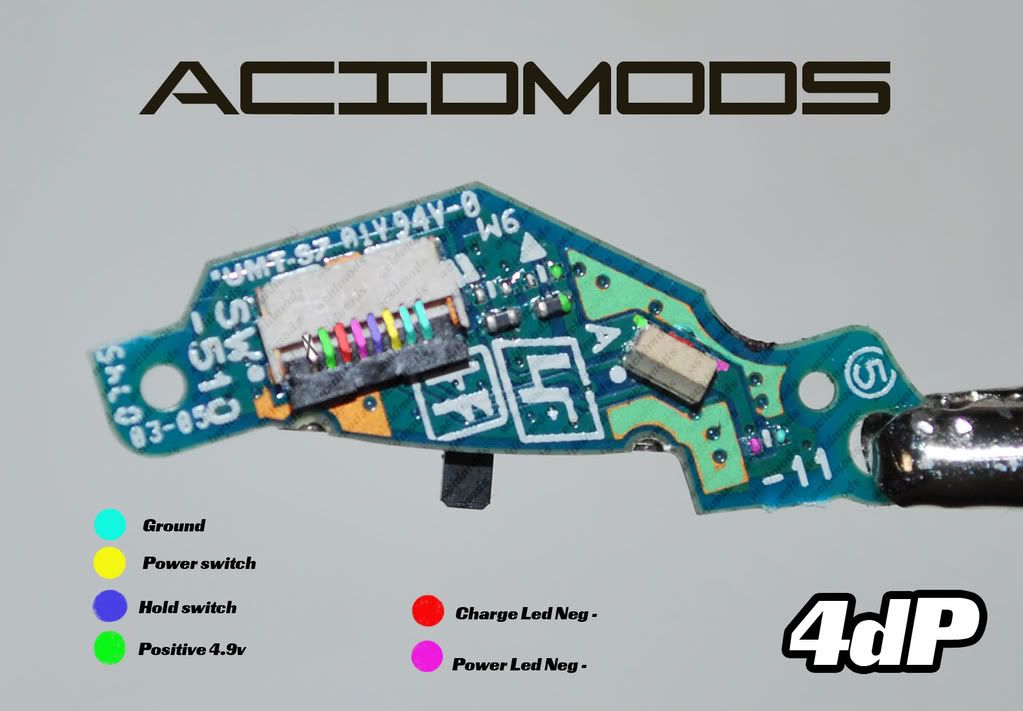

how can i do it to the slim? i tried to but the power led is always on even thou the psp slim is off. can someone tell me how to do it or draw me a diagram showing how to solder the leds the the 3 points.

try soldering the leds to short wires then to power boards and you accidentally soldered the power or the charge led neg- on the ground
look at this diagram for help

i just did it like the phat led swap i soldered the charging led to the bottom points and then soldering the negative side of the on led on the last point, then i just got a lil wire and connect the bottom (4.9v)point to the positive led side of the on led.
