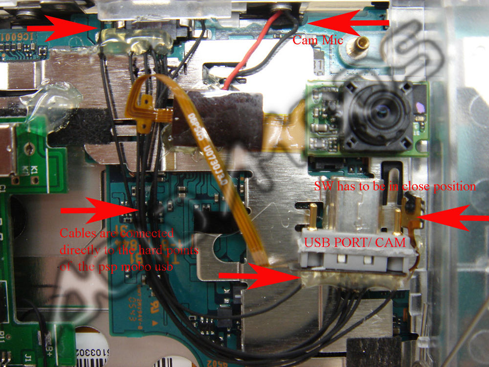

Microphone is one the go cam
so when you internalize it.
You'll have the mic.
(mic is in the top right corner attached to cam)
Thx :clap:
But one last question! :beg: Do I have to remove my UMD drive and my USB port?

you can put the cam in the back of the psp.
on the opposite side of the battery.
and keep the umd drive.
and to keep the usb port you gotta add a switch to Data+ (D+) if you wanna use usb mode.
Diagram:
Do I need to buy other materials apart from the Go! Cam? Also, can you make the picture more understandable (I'm new to PSP Hacking! :yess:)

Lol It's not hacking it's modding.
but things you will need are:
15 watt soldering iron
30AWG wire
0.015" solder
Soldering paste, Flux (not needed but makes it so much easier and recommended).
all of this can be found at radio shack.
and a slide switch for the usb Data+
from mouser.com
A psp screwdiver (find a small Phillips head at home depot or somewhere)
I'll make a Diagram tomorrow.
But what did you not understand?
The diagram was ALL over the place!

Offline Barnsey
  • Posts: 260
Re: Internal Chotto Go Cam Mod
« Reply #13 on: August 05, 2009, 02:31:06 AM »
thats what the switch is for
it disconects the cam from the usb so you can use usb normally
correct me if im wrong

on the usb to camera add a switch to the middle pin (the third one and the yellow wire in This Picture.)
and make the wires long enough so you can fit the cam on the case on the opposite side of the battery like in the video.
I am new to hacking and 13 years old, so, could you please provide a picture so I can understand?
