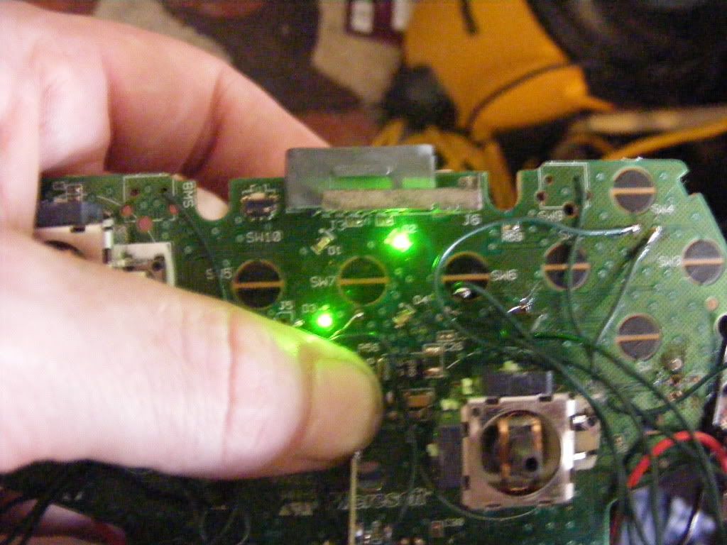

Hey my names Justin and I have muscular dystrophy. ive built my own controller 4 the 360, i need help refining it and making additoins to it.

I'm in process of putting up few more pics.

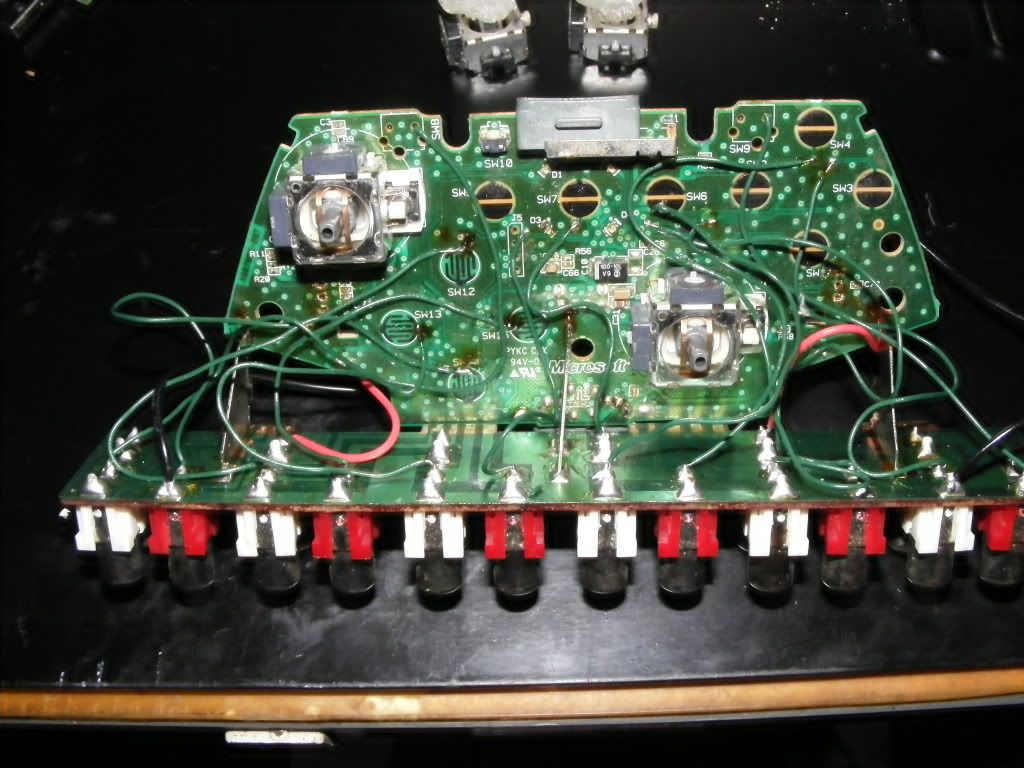

If your up for it, here's whats needed:
1)   A RCA plug board to easily switch buttons around
2)  A small joystick set to the d-pad function(the small joystick in a saitek cyborg as shown below would be ideal, however it needs to be next a finger on my right hand. Is possible to find those small joysticks without taking apart another cyborg? my current set up is shown below.
3)  Additional foot buttons(I'm pretty sure I got that figured out, can do that on my end. any ideas are welcome though.

I would recomend using pin headers over rca connectors as they are dirt cheap commonly found and allow you to make a custom plug n play connector system. you could then hook every button on the board to one connector and make as many addon modules as you want that use the same common connector. I'd draw a diagran to better explain but im on my phone :(

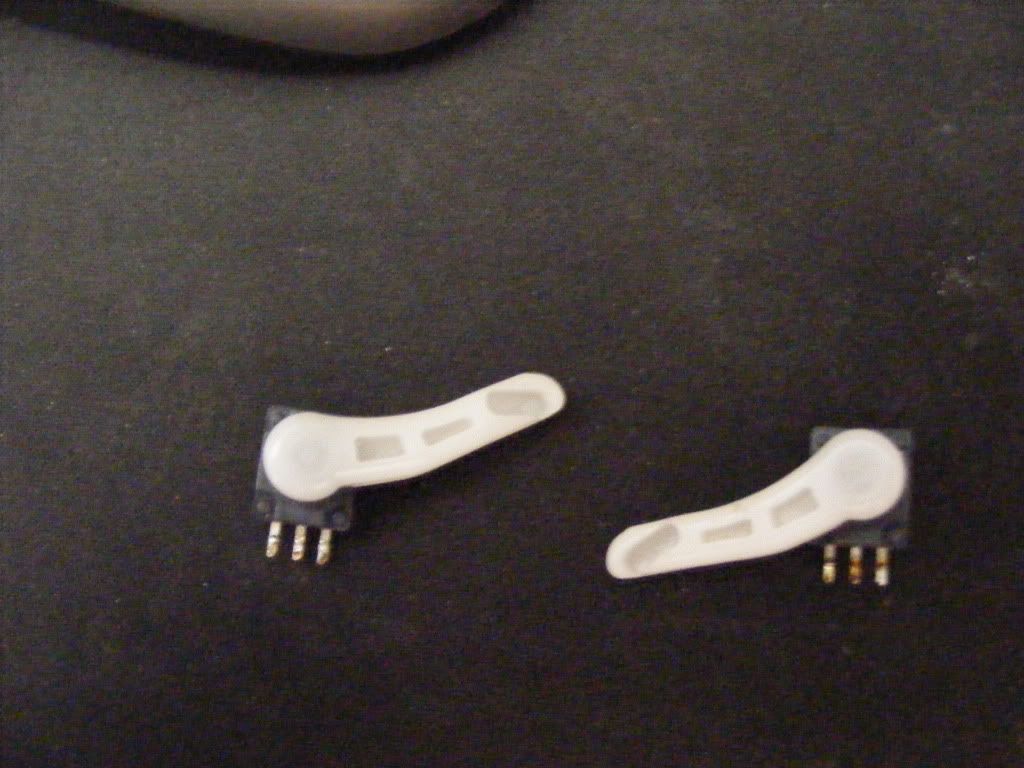

I got something in my head that I think will do it all. But I will come back to that. First the dpad idea is exactly what I am using for someone else. Its called a 5 way micro switch. The newer versions are now 5way which means you push down for a 5th button. They used to be 4 way on the cyborgs .
I am working on track ball stuff now also... Unfortunately it will only work on PS3/PC right now.
I found a replacement blackberry track ball , its actually real accurate and really trick looking.
It works with hall sensors instead of pots. So unfortunately xbox controllers can't hook up to them. But there might be a way to use a roller ball somehow from an old mouse.
I have an idea for helping aiming and its along the lines of a flight stick/joystick hybrid . I'll get to that when I get some more progress with the basic design.  I have something I'm all ready working on that I think will fit your needs If I just modify the design a lil. I think I can make it so you can have almost a whole controller all done in your right hand.
here's a lil preview of whats at the core of the build. A handle is then molded around this. I added the spring but with out it it snaps back ok. With out it its very easy to move. I could do it with my pinky.

Note: when building the rca jacks for buttons add stereo head phone jack for each analog, x,y each have separate plug with v, x , ground , the y would have v , y , ground. I think we should have extra v, and ground spots.

Couldn't you just give every button a ground and a positive lead, it's what I did because the controller I used had no common ground. Just my suggestion but you've been doing this stuff long, so as long as the plugs work I'll trust you.  :hifive:

My pics have a few notes on them too. 1st pic is for my fingers and the 2nd is for my thumb behind the joystick, I also wanted a thumb post to use as leverage for aiming.

First shipment of stuff received .  I am starting tonight. (technically I already started on the connection board)
Just in case the 5way switch idea doesn't work out I will build a standard box holding abxy etc buttons. It will be plug and play like the rest. As a back up plan for buttons, i think dpad will be fine.
I made a decision on the controller type. I will use common ground, it will make swapping at the rca board easier and give almost unlimited options. But we wont have the shift button.
Also I have been thinking about your toe triggers... Can you push normal controller triggers down with your toe? (my original plan wont work) But if I mount these to a base that would be like if there was a controller at your feet facing away from your foot. I would modd the trigger to be more toe ergonomic. Can you have someone hold a controller at your feet and see if you can controller trigger function this way? If so I think we are good to go... One side note.. these 5way switches are tiny. Is a standard xbox controller comfortable in your right hand? (right hand controls only) No trigger use , just holding the controller and using the right stick and buttons? I was thinking about chopping up one of the shells I got and mounting right hand controls into the 1/3 shell. I have many shells , I have ps3 /ps2 style also if they are more comfortable? I would mount the  3 5way switches into the button holes and mount a stick where the right stick belongs. The last button hole could be used to control RF or what ever you want it to be.

A lil bit of an update, I'll post some more pics soon.
These svideo plugs will be used for analog connections.
The toe triggers w/o springs and toe pad. One is all the way up, the other is all the way down.
