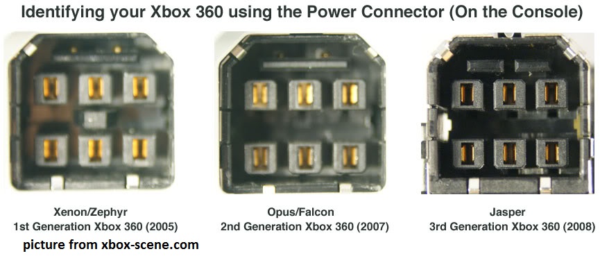

Determine which type of mother board you have by looking at this picture.

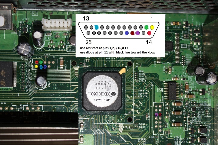

Make jtag connections, look at the picture below for your type of motherboard
edit: here is an alternate wiring method that has been found to replace the "all other board" pic. this this new "reverse" method, all connections for jtag are done on the bottom of the mobo and are easier to get to.

Make LPT cable connections this is the same for all motherboards.

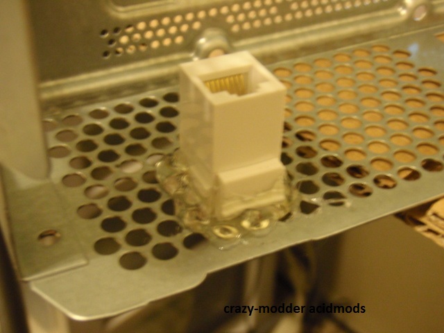

Mount  a rj45 jack mounted under the HDD
step 5
Then use one end of the Ethernet cable soldered to the motherboard connections,
Connect the other end (matching the colors) to the db25 plug.

Re: Jtag tutorial
« Reply #16 on: January 24, 2012, 10:35:46 PM »
should there be something connected to pin 3? or is that just a typo in this image?
Re: Jtag tutorial
« Reply #17 on: January 25, 2012, 02:22:30 AM »
there is a typo in that image,
100ohm Resistor should go on pins 1.2,14.16 & 17
Also I am not sure about the diode on pin 11 crazy-modder's doesn't show it on his . as shown above.
« Last Edit: January 25, 2012, 02:43:23 AM by Rodent »
Re: Jtag tutorial
« Reply #18 on: January 25, 2012, 05:03:34 AM »
you are correct on the resistors, that is a typo. I will fix this weekend.
as for the diode at pin 11 this is required on any mobo other than xenon, and I still recommend using it then. without it you will get read errors on every block.

ok, your post is confusing. but ill try
the alternate jtag points for non xenon boards is posted in reply #8. these points are all on the bottom of the mobo. (I strongly recommend protecting your efuses while your back there!!!)
as for the red wire you speak of, I think you meant yellow, and it is also accessible from the bottom in the alternate points/
Sorry about that post, it was late. I was talking about both of them, the red one has a very small point (to the left) which I am not so confident about soldering and from reply 8 can you substitute points from the original diagram for that one or do all points have to be from one or the other?

in reply #8 everything is done on the bottom, you will only do these points. dont do it on the top and the bottom.
you dont need to bring anything over the top, but if you did, the corner of the fan is a good spot.
so:
do the jtag points on the bottom of the mobo
do the lpt cable connections on the top
protect the efuses. here i will look for a good pic of them one sec...

Found a great tut on that http://team-xecuter.com/forums/showthread.php?t=62331
Ok and thanks, the reverse method is def the best and the tidiest.

I do not recommend bridging the volt regulator or whatever that is, just remove the r6t3 resistor. If you ever wanted to put it back you can just take any 10k ohm 0603 resistor and solder it in place.
Re: Jtag tutorial
« Reply #27 on: January 28, 2012, 06:47:49 AM »
the tut is good.  its a matter of preference, i never remove the resistor, and just bridge the points. never had an issue, ive never needed to undo it, but if i did a solder wick would clean it right up.
