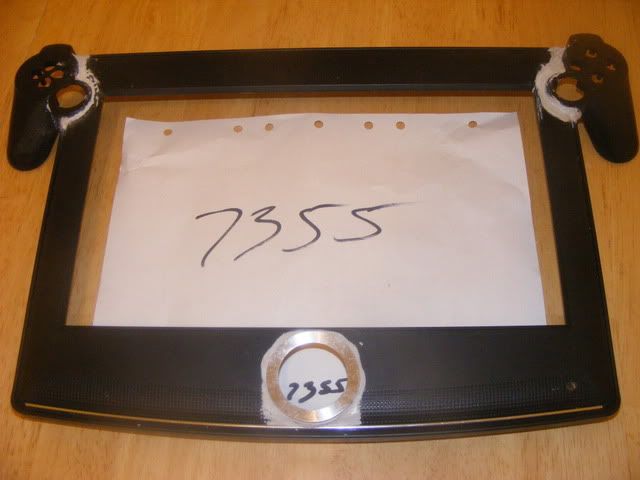

The case mod started... I gotta say its off to a good start. It feels good in your hands. I know this thing looks huge but really w/o battery its lighter than my fat boy PSP.
Right hand controls
Left hand controls
UPDATE: 1/22
Afternoon update: controls put into place. Had to cut up the control board. The buttons i am using do not have resistance on them. They are not pressure sensitive. I will be lighting these buttons on press. I might do 1 color for constant and another for press.
Side note we need psp touch so I can make this into a tablet. ANDROID OS on psp would be sweet.
« Last Edit: January 22, 2012, 01:07:01 PM by 7355 »

« Reply #25 on: March 13, 2012, 04:54:53 AM »
A lil bit of an update before debut.
I did some testing with some PS3 games that are whats called blue ray mirrored, instead of direct boot. And boom I was playing a whole new batch of games. These games boot from regular xmb after multi manger boots it. First game tested with BR mirror was Alice madness returned. I love that game and waited for a while for a patch to play it on my modded ps3. The patch came and it made it only play with br mirror. Some games can only be played w br mirror and/or direct boot. Fear 1 and 2 worked played very well on the "PS3GO".
Also I ran a new eithernet cable for my ps3 so my ps3 can be hard wired into my network. This makes for better streaming on my network.
Also I have put some thought into building a controller with a dock for the go as a side project in the future. Just to have simple dualshock controls for the go.
What I like about this mod is the PS3 does all the work, so the graffix are not psp at all. They look better on my psp than on my projection tv.

« Last Edit: March 29, 2012, 11:18:27 AM by 7355 »

Thanks for the help. I will be running off dc wall power for now. I do not feel safe messing around with a 3s lipo. I will order a new battery in the next couple days. Should be here in a week or 2.
So I am down to assembly. I put everything together and tested and it works good. I do not like the feel of the buttons and the dpad. The buttons them selves feel awesome , its they dont press right. They are clear silicone filled and back lit with smd leds. The leds are hooked up to a fader chip. The triggers are on 1 cycle, the buttons on another, and the PS button is on its own. I ran out of leds or i would have installed them in the R1 and L1 buttons too.
One last touch before its ready.
So here is a teaser before the final paint.
Erin_Schnare - DSCF6527.mp4
This is going to be close.
« Last Edit: March 29, 2012, 11:59:11 AM by 7355 »
