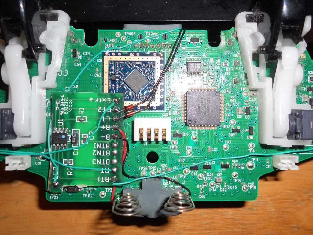

Here is my wonderful install of King Mike's 7 mode matrix. I will be doing a full review when I figure out all the details. As with all the stuff I have gotten recently, details provided where very vague .lol.
Oh and yeh I wanted to post this so Matt could have a good time with my wiring :)  :drunk:
Yes it needs some hot glue loving. Just testing before glue it all down.

the diodes are bare wires, cut the leads shorter and protect them from the main IC.
and cut your fingernails.

Rofl. I was going to cover them with hot glue.
How the hell did you know those marks where from my nails? They are not that long, cheap wire was melting back as I was soldering.
@ Rodent. No body told me that so I found a spot haha.
lmao is it weird that i enjoy reading your comments haha
yes yes and yes
that pcb was made for the back parts of the shell not the xb controller pcb
do insulate those diodes
and cut your fingernails as matt suggested lmao

Yeh I see where it should go now but I can say even If i had known that it would still be where it is now. It would be a pain to wire it up from the back of the shell.
I will be insulating the diodes before I put it back together. Thanks but that was already planned as well as gluing down the wiring .
As for my nails... I dont see how any of that is relevant to the controller but yeh sure.

wow!!! I just notice the left trigger.....
and the fingernail comment cam e from the way all the wire sheathing is broken just before the solder point. this is generally due to you holding the wire down with a sharp tool or fingernail, when you solder the heat transfers to this weak point.

If you are reffering to the burn on the pot then its dust. Looks like some one replaced the pot before and did not clean up the flux.

15 watt soldering Iron and FLUX!! Nuff said

30 watt is all I have so I must make due!!! Nuff said!
crap man thatll burn the  :censored: out of pcbs like that 15w should be the max to play it safe stick to 10w

I Only Solder With A 70W Adjustable Temp Iron Station. Never burnt Anything. Lol Knocking On Wood.

All I have is my Radio shack 30 watt. That is what I must use. I am aware it is to hot for most small applications. It is also just right for my larger repairs and RC related jobs. Thanks for the input though..

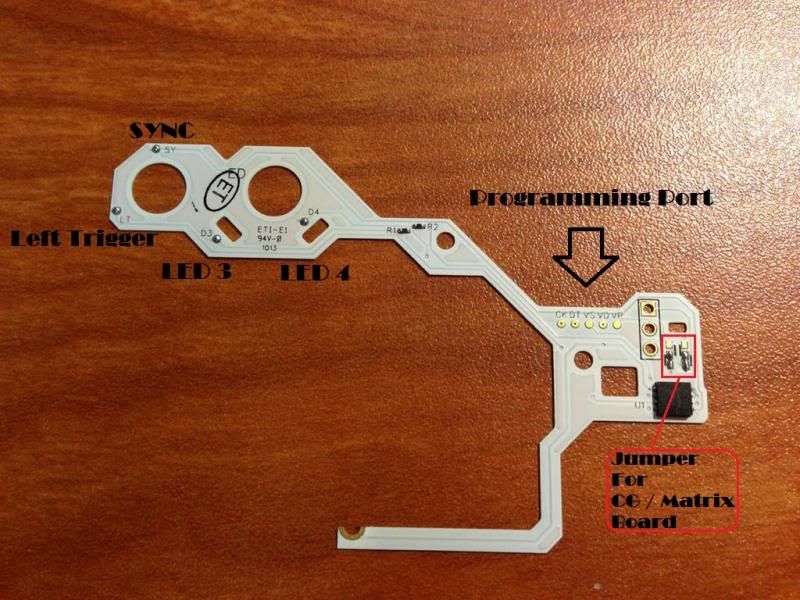

Here is much faster and Cleaner Option
New Board Works on CG1, CG2 , Matrix 1, Matrix 2 Only 2 Wire to Install
2 Code Options
