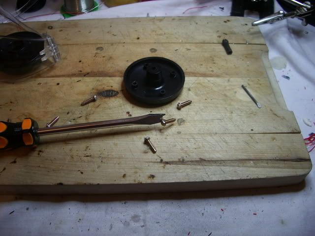

I just made a Nintendo Screwdriver
« on: January 21, 2007, 09:30:21 AM »
Yay me!
Now I can overclock my N64. Get in!

Re: I just made a Nintendo Screwdriver
« Reply #3 on: January 21, 2007, 05:13:54 PM »
dam, seems youre having more luck or skill whichever one, mine just wont turn the gamecube screws...but theyre so far in I cant see whats wrong, maybe Ill try it with my n64.
It wasnt to bad. I just had a go at it and got one screw out after a bit of a struggle. Then used that screw to get it perfect. I'll mesure it out if that helps
ok, and I think my problem is that the groove isnt deep enough into the head...I think its wide enough, cause its 3 cds thick, which is the suggested thickness, and I can really go that much wider, but Ill try making it deeper, see if that helps, not sure when Ill be able to do that though,...but please do measure it too, Ill see if thats the problem before I dremel more out.
« Reply #5 on: January 22, 2007, 11:37:16 AM »
Just checked mine and it is 3 cds wide. Its about 4mm deep. I also made tapered it to the tip, so its quite sharp. Let me know how you get on.
