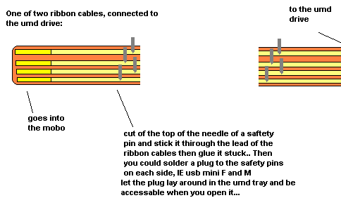

Here is my schematic, my question is below the picture, and pardon my English ^^
My first question obviously would be do you think this would work? The main thing here is the triple battery thing.
And would I still have room for a internal camera? One that would be as little as possible visible (don't have to be invisible or anything :P )
And with the internal camera, would the USB charger mod still work?, I'm guessing it would work with 3 batteries parallel.
Well removing the UMD tray has been done for loads of mods, ultimately this mod wont leave a visible trace(except a possible camera)
do you think there is room for 2 slim batteries, and I'm guessing i should have a slim battery in the original slot to if they are connected in parallel.

« Reply #1 on: December 30, 2007, 03:54:51 PM »
well i put two battery's on the back of my slim and they both barley fit so idk. it is going to be a touch job

« Reply #2 on: December 30, 2007, 03:56:59 PM »
Why using slim batterys? They have less capacity and are so small that there will be some room left for more, but you can't find any more batterys in there. Use some cellphone batterys, stack them , there can go 2 batterys for each "Box" you drawn, that would be a total of 6 batterys, pick some with 900 mAh each, that would be 6x900mAh=5400mAh.
1800 mAh will give you lets say 6 hours, 6 hours x 3 means you got 18 hours of gaming fun with your PSP. But be aware, that many Batterys weight alot.

« Reply #3 on: December 30, 2007, 04:01:55 PM »
I figured that the camera is to space consuming, and it does not agree with the charger mod, or even usb file transfer....
so I'm leaving it out....

Re: Triple battery mod
« Reply #4 on: December 30, 2007, 04:53:45 PM »
*sigh* Wait for mine,it's coming soon.It doesn't use the drive,and ALLOWS the usb charger,and the use of the usb still. I'm buying my new camera soon,and I'm making it for the slim.It's the same concept for the phat though,so keep an eye on the slim section,and watch my sig,I'll keep updates in there.
As for your mod,not even one phat battery will fit,they're took thick.Like fufa said,try using cell batteries,or try NDS batteries for more,but the mAh is far less.

Offline Siggen
  • Posts: 106
    • FileSock.Sourceforge.net
« Reply #29 on: January 10, 2008, 04:35:53 AM »
well its really possible, here is an example of how.. (the pin tips is thanks to pvp, he used it for another thing)
Tech Support Crew at The Gathering 08 (worlds second biggest LAN party)
