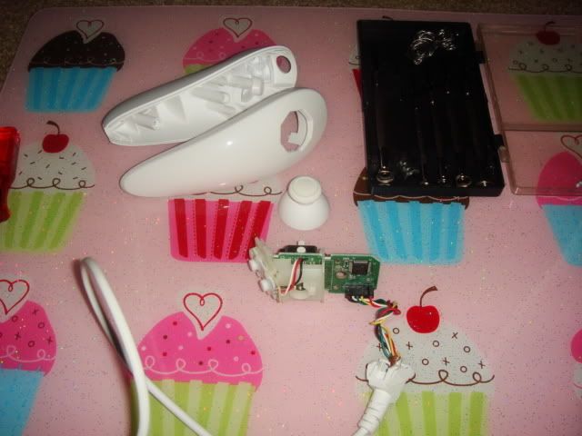

Now you take your tri-wing screwdriver and you take your nunchuck apart like so
Step 3

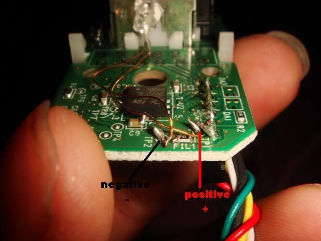

You take your 3mm led and you solder to these points on the nunchuck board like so
Step 4
Now your nunchuck should look like this

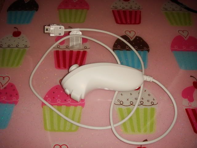

You plug your nunchuck to your wiimote and see if it works if so put everything back together like this
And there you go your modded nunchuck now on to the wiimote

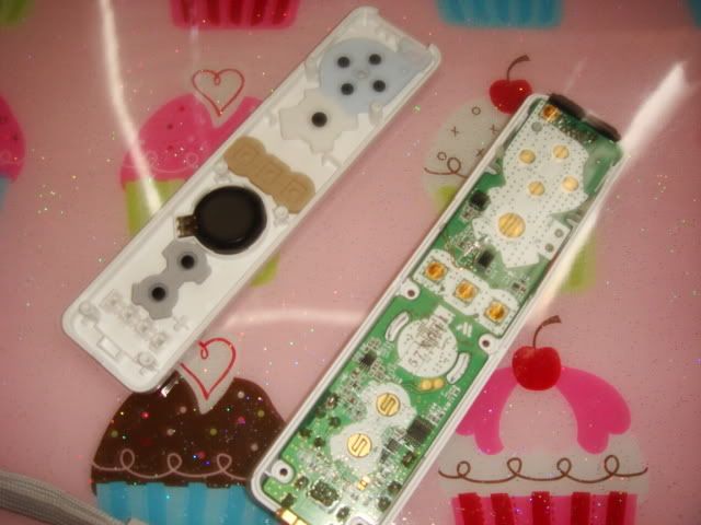

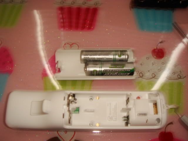

Step 1
You get your wiimote and take it apart like so
Be careful on this part take your phillips flathead and pry your wiimote cover off but dont break it
Step 2
Now you take the board out of th casing and flip it over
Step 3

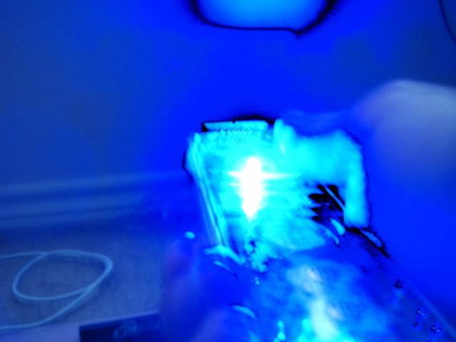

You solder your 3mm led to these points
Step 4
Now bend your led over to the other side and position it like so
Step 5
Pop your batteries back in and see if it works. im my case it does
Step 6
If it works put your wiimote back together

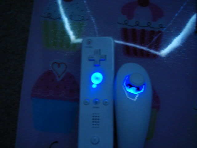

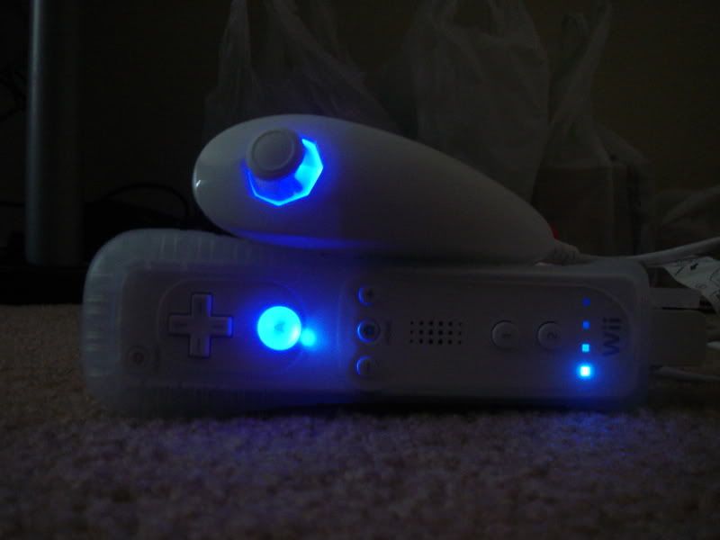

CONGRATS! :buttrock: YOU JUST FINISHED YOUR WIIMOTE AND NUNCHUCK MOD! HERE IS THE FINAL PRODUCT!

Put tape over the place where the LED shines through the plastic, to prevent the "Bleeding", bleeding is that blue spot you see that shines through the plastic.
