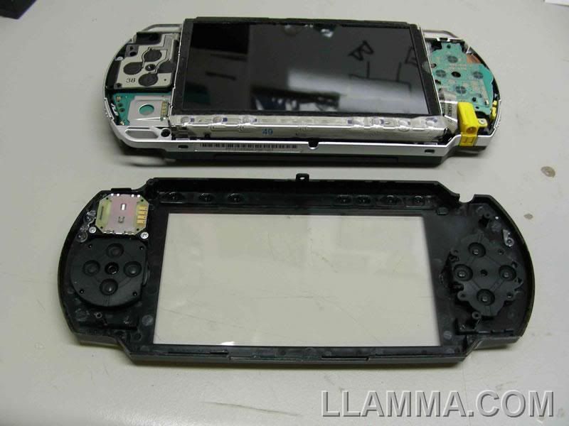

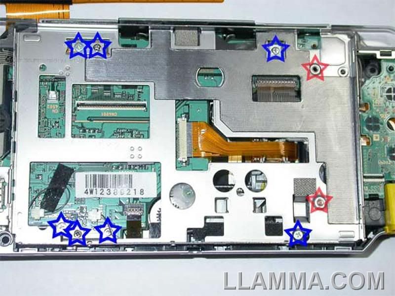

Disimable your psp all the way to the mother board to do that first off you need to remove these screws
once you've done that you should have this

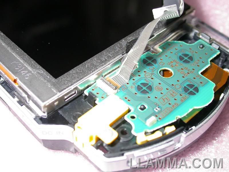

Now what we have to do is remove the button board like this
once done that release it from its clamp and take it out

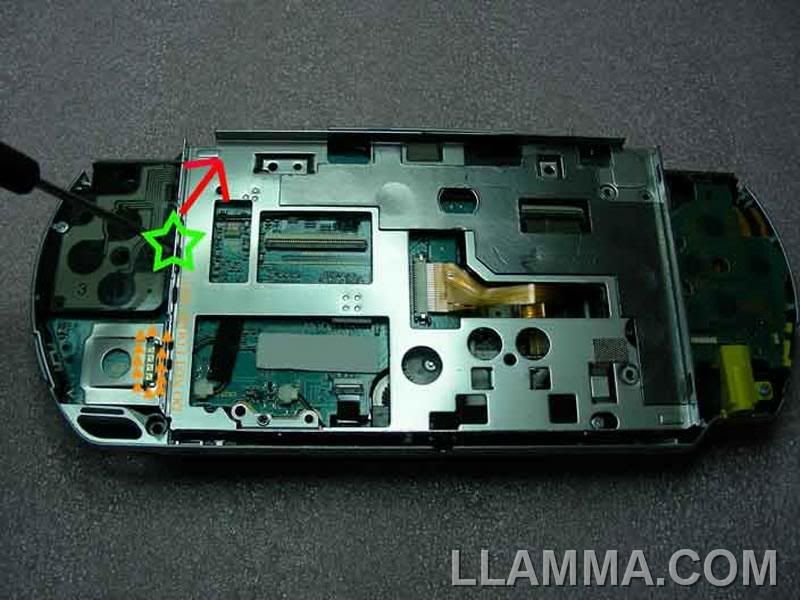

now we have to remove the lcd screen by gently pushing your small flathead down the side and
lifting it up as example:
<a href="http://s267.photobucket.com/albums/ii299/lil_miss_frizzy/?action=view&current=01170620044.jpg" target="_blank"><img src="http://i267.photobucket.com/albums/ii299/lil_miss_frizzy/01170620044.jpg" border="0" alt="Photobucket">[/url]
this bit is pretty hard dont worry if you cant do it  took me like 4 hours to figure out how to remove the screen.
once the screen is out of its cage you need to remove it from its clamps like this.
once done that we need to remove the LCD screen cage to do that you have to remove the screws
pointed out in this pic.

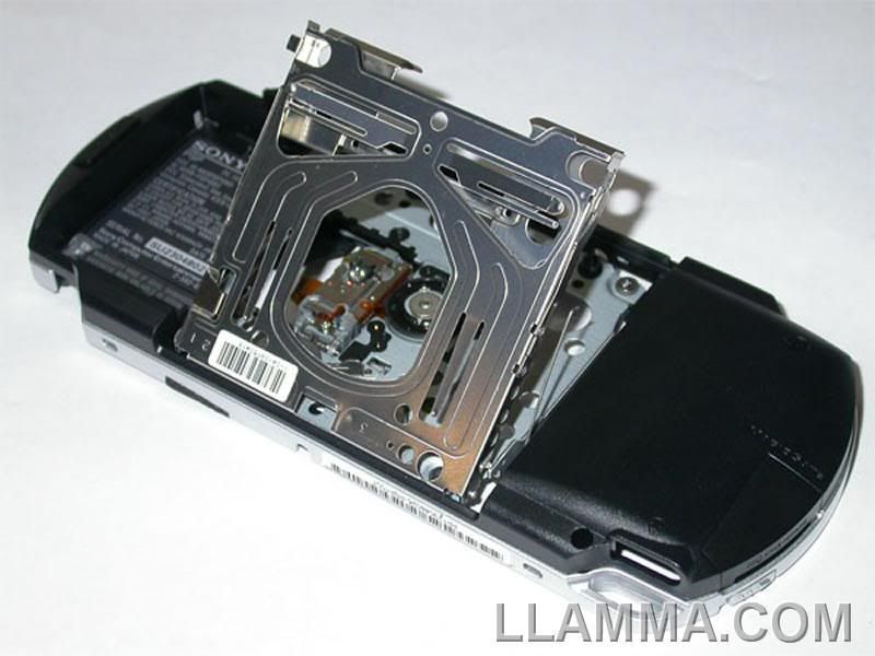

now what we have do is pry the umd door cover hinge which is pointed out in the next pic
(excesive force will brake the hindge witch is bad)
once done that the umd door cover should just pop off =] (nearly done)
and you should have this
once you have that you have to push the cage off it hindges like this.
(push it the the way it points on the pic)
once done that you should have this
