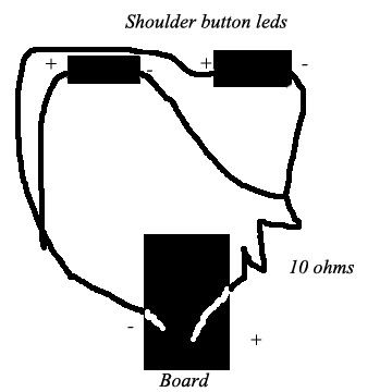

Ok I am a bit confused on how to wire this so I am going to post two wiring diagrams and I just wanna know which one is correct.
so just wondering which one is correct as the first would be easier but for some reason the second seems more correct. or will either one work. and if neither work could someone please post a wiring diagram. Also the board in mention is the circle square triangle x button board. Thanks for the help
Re: PSP Trigger Mod fixed pictures
« Reply #71 on: March 31, 2009, 05:59:51 PM »
use the bottom one
