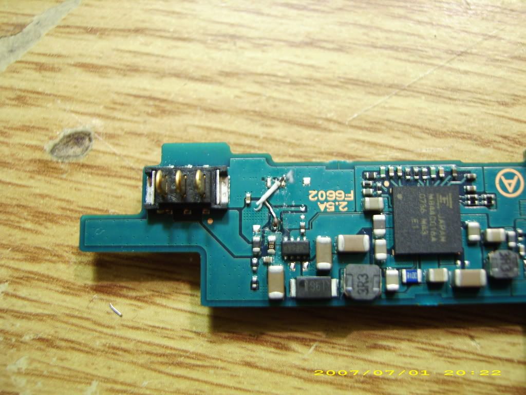

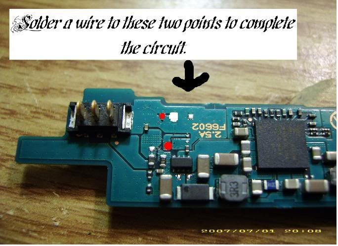

Ok..There are two switches that have to activate the UMD drive in the slim..One just like in the Phat, and another one. Well, The switch is in the top corner closest to the battery.
My little black nub fell out and I don't know where it is. So I disassembled my psp, took out the mobo, and did some continuity testing on that switch.
Here is the switch without the silver top on it:
What I did next was took the switch off of the mobo and there were 3 points that the switch was soldered to. After I did some continuity testing, I soldered a wire to these two points to activate the umd drive.
It should look something like this after you are done:
You can actually solder the bottom contact the the contact right next to the one I soldered to. They are connected to each other...( The multimeter doesn't lie )
I put it back together, and It worked!
 :tup: :tup:

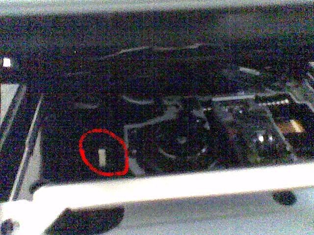

there is another switch on on the umd drive. it's on the right hand side of the umd drive. There should be a little white switch that activates the laser when a umd is pressed against it. i'll see if i can a picture. i'm at work at the mo, so i don't have anything with me.
Thanks for the reply, i dont see any little white switch. I would appreciate it if you would post a pic of it thanks!

It is actually black

« Reply #5 on: September 18, 2008, 07:56:55 AM »
Is it this one?
P.S Sorry for the really crappy quality i took it with my mobile, i couldnt find my cam

Bingo
I would play with it and make sure it is getting pushed.... by the UMD.
did you open your PSP?
If so I would verify the wide ribbon cable that comes in from the right (on the front of the PSP MB) is inserted correctly also.

I am now 100% sure that the ribbon cable is inserted correctly maybe if i try to solder that button thingie again he sayd something about another place to solder
Does he mean those two?

Yeah, but the other place to solder is already connected to the other one... the two contacts are connected for some reason. Check continuity. Thats how i came up with it  :tup:
So either one should work

This fix isn't working correctly for me. My friend broke his switch and I connected the 2 contact points. The UMD spins for 1 sec then stops spinning. How do I get this fixed??

It's a switch. Switches usually let current go by under certain circumstances...so, with that in mind
I used continuity on my multi. The bottom contact and the two top contacts were not connected in any way. I checked the top two contacts and they are connected
So i figured you can just connect the bottom contact with either of the top contacts.
There can be a few things you can do:
Since it isnt working, if anybody has a switch check it out and see how it works.
Then inform us ( I no longer possess my switch )
Or you can try to connect the bottom contact with both top contacts.
In my first picture there are 3 more contacts to the immediate right of those 3 contacts. Can anyone tell me if they are used by the switch? It has been too long
Sorry for all the trouble guys
Good Luck  :hifive:
