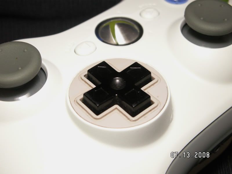

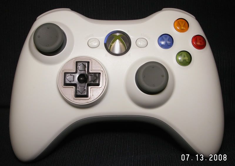

Yep, I did it again. This time with the D-pad from a poor old NES controller that has seen much better days, dunno what chewed the cord up on the thing, but it must have been right tasty.
That screw up there on the side of the D-pad is from shaving out part of the inside of the D-pad area for the wiring to have room. It wouldn't be there if I'd have been paying just a tad bit more attention. It really makes me want to scrap the whole shell and do another one, which I'm sure sooner or later I most likely will do because I am apparently that OC about some things, honestly I plan to never use the thing anyway, just did it to do it and see how it could be done. ;)

Make sure ya have either the CG version of Wireless controller board or CL version of Wired controller board before ya go hacking anything up though. With the older Matrix version boards you can't do this on them easily because of how they're setup internally. The CG and CL boards can be wired up to the NES D-pad easily, since they both share a common 5 wire setup, ground on the CG and voltage on the CL. The Matrix versions of the controller boards by comparison use 7 wires for the D-pad. It would be possible to cut the traces on the NED pad and rewire it to conform to the Matrix setup, just more work is all, but it can be wired right up to the CG or CL version boards much easier.
