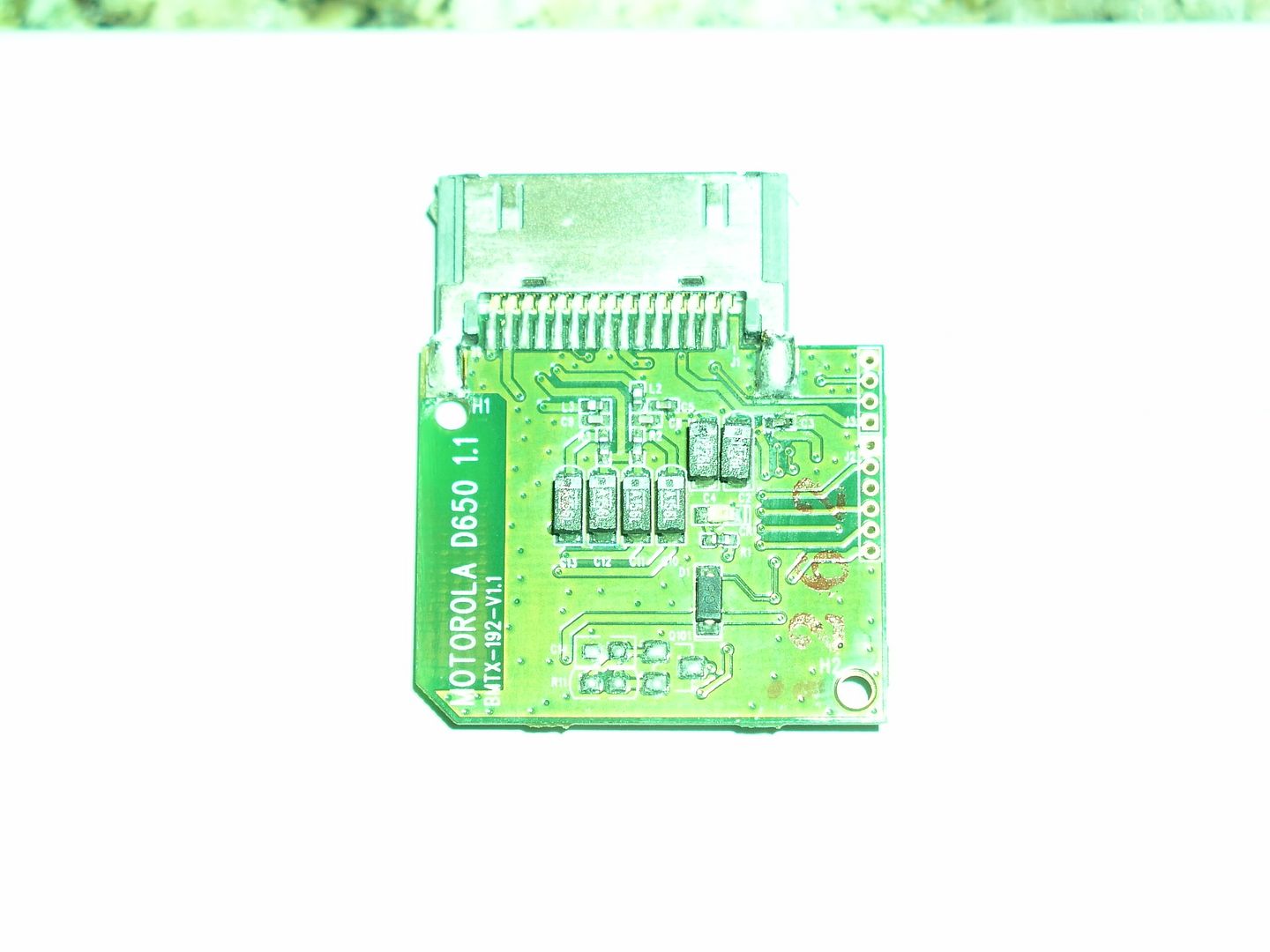

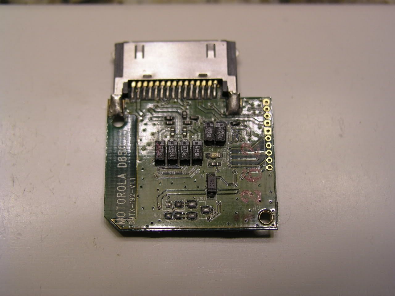

Ok, so I found another set brand new for really cheap. This set includes the Moto D650 adapter that fits the IPod dock connector. In fact, I bought this set cheaper than I could buy the Sony TMR-BT10 bluetooth adapter that plugs into the 3.5mm headphone port. The Sony does include a rechargeable battery in its setup, but I would rather just derive the power form the PSP itself.
So, on to business. I would like to know I you guys think that I could wire the D650 IPod adapter up to the PSP. Of coarse the PSP will have to supply the power to the D650, but I think it is possible. Basically just audio transfer would be just fine, but if the D650 is capable of sending the command signals (play/pause, foward/rewind track, next/previous track, vol+/vol-) to the PSP, that would be sweet.
Please forgive me if someone has posted something like this before. I have already done some extensive research in trying to find the serial pinout for the PSP's remote. I know it is out there somewhere, I just cant seem to find a good source. I did find the IPod connector pinout however.
As far as I can tell, the IPod uses 3.3v stepped up to +5v on PIN 18. PIN 23 is also +5v. PINS 19 and 20 are +12v but are used for FireWire.
I already took apart the D650 to take a look at the connections. It appears that all the connections are soldered on to the board, but I am not sure which all PINs are being used. This board is a nice choice since it is just slightly larger than a US Quarter (not including the IPod connector piece). The BT antenna is also part of the PCB so less chance of breaking that part (which I like). My problem is that I do not have an IPod so I am not really sure how I would connect this thing to test the connections. I believe the the whole PCB is being powered by PIN 18. Or, it might just be powered by the Right+Left audio input (which I dont think makes much sense).
I was thinking of just adapting a stereo 3.5mm plugin if that will supply the power. Or if not, buy a cheap Remote on FleeBay and adapt that.
How would I go about testing this thing to see what all connections are actually used? And does the PSPs remote connetcion supply 3.3v power?
I am looking more for the PSP Slim info but would also like to have the info on the PSP Fat too.
So you guys think that I can at least transfer audio over bluetooth?
Here are a few pics. Mabe they will help.
Let me know whats you thinks.
Thanks.

What you want to do is very easy.
Yes the PSP can supply power for the adapter.
Here is the pinout for the connector on the ipod transmitter.
http://pinouts.ru/Devices/ipod_pinout.shtml
Pins 3 and 4 are you right and left audio outputs from the IPOD to your transmitter.
Pin 2 is your audio ground
Pin 18 is your 3.3 Volt power into the module
Pins 15 and 16 are your power grounds
So if you hook 3 and 4 to the speakers of the PSP
Pin 2 goes to the ground side of the two speakers
Pin 18 goes to the 3.3 volt power in the PSP
Pin 15,16 go the chassis ground of the PSP
Then the unit will transmit stereo to the headphones.
OR
You plug this in and it will transmit to your headset.
http://www.dealextreme.com/details.dx/sku.9675
Sup to you

Well, rceckspurt13    if I accidentally wire up the 3.3v from the PSP to the Right/Left on the D650, I would probably FRY it. :cry2: Not that I am that stupid :huh: but I still do not know which PINs on the D650 do what. The IPod diagram that gr8npwrfl mentioned is the one that I found. Even though the diagram can be matched up to the D650s connector, I have no idea what happens to the input (right/left, power, ect.) once it goes through the PCB.
How can I test this thing without having an IPod? You see, I need to figure out if the D650 is running off of 3.3v / 5v or a mix of the two.
Thank you gr8npwrfl for your input. Yes I have seen that adapter before, however it is external (meaning it wont fit with most PSP cases or other mounts) and is made for the Fat PSP. I have 2 Fats and a Slim, but I really would like this on the slim.
What I really need is some sort of diagram that shows where on the PSP to get my power and inputs.
I have also thought of just adding the PSP serial remote connection hardwired into the D650 as is, so that it can be used as intended for an IPod and also for a PSP. You know, just solder the PSP remote wires to the pins inside the D650 and have the PSP connector on the opposite side of the IPod connector so that all you have to do is flip it over to use on IPod or PSP.

From the pics I have posted, can anybody tell where the power route goes too?
Does anyone have a pinout diagram for the PSP Slim serial connector? Does it supply 3.3v or 5v ?
Thanks guys in advance for your help.

Well that breakout adapter is very handy. I really dont need it tho. I know what all of the PINs on the D650 are, I just dont know where the power and inputs goto on the PCB once they are past the IPod connector piece.
WHERE DO I GET THE POWER FROM? Can I get 3.3v of 5v power from the PSP Slim serial connector?
DOES ANYONE HAVE A PSP SERIAL CONNECTOR PINOUT DIAGRAM?
