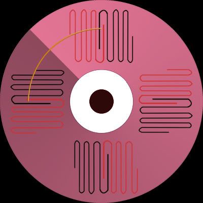

I have seen custom Beatmania DJ controllers that use quadrature rotary encoders to sense the turntables direction of movement (like the official controllers), but they are not simple to build. It all depends on how the stick is required to function within the game. If it is only required to rotate in a clockwise or counterclockwise circle then you might be able to use a simple mechanical gearing system from the axle to rotate an analog joystick. Could you explain a little more about the motor? Is there a part of the game that requires continuous rapid rotation of the analog stick? I have never played any of these games before, so I am not sure how all the controls and game modes work.
These pictures show more clearly the grounding method I was trying to describe in the other thread, this is where I grounded the analog stick in the PSP.

That makes everything much simpler. So if I understand correctly, the controller requires:
  • The CD to be able to spin freely in either direction.
  • Any rotation of the turntable (CD) to simulate a directional movement (in any direction) of the PSP analog stick.
  • Directional movement of the analog stick to be active whenever the turntable is in motion.
  • No movement of the analog stick when the turntable is stopped (stick is centered).
  • A switchable mode to activate the spindle motor during music playback.
I have never built a rotating controller like this, but I think you should be able to do all of the above with a rotary encoder and microcontroller. The microcontroller can be programmed to send a pulse to one of the X/Y axis contacts on the analog stick when a change in the turntable position is detected by the rotary encoder. Because direction of movement and amount of rotation are not important, the rotary encoder would only be needed to sense a change of any kind in the turntables position. The microcontroller could be used to set the sensitivity of movement detection, and turn the CD spindle motor on while disabling the pulses going to the analog stick. A correct amount of resistance would also need to be applied to the pulses to avoid throwing off the calibration of the analog stick. Just one possibility.

You can find miniature encoders at surplus sites.
They have two outputs most of the time.
One output is high for clockwise and low for counterclockwise. It just tells you which way the
cd is spinning.
The other output is a square wave pulse. It normally is hooked to a counter. The direction
output is normally tied to up/down count.
So when you spin one direction it counts up, and when you spin the other direction it counts
down.
So if you divide the cd circle into quadrants, you can take the max count and min count to a
simple 8 pin Pic cpu and have it generate the x and y analogue values.
Just like a dj when he works the turntable if you move back and forth in small movements
the x and y would toggle back and forth.
This should give you the effect you are looking for.
Or if you want more like the analogue stick, just take an analogue stick from a PS2 you could
wire it in place. Glue a plastic shoulder to the joystick stub and then when you tip the CD it
will work identical to the original joystick. This would require no software and no computer chip
to work.

This would require no software and no computer chip to work.
I'm thinking of doing something like that, actually I'm giving it a try now but stuck with something,
- Basically I'll glue a CD under the Motor, drill holes on the CD, and glue the analog contacts like this:
Red is signal, Black is Ground
- Then, glue a piece of stripped wire on the CD im going to rotate:
- And u'll have all the directions (Right, Up-Right, Up, Up-Left, Left, Down-Left, Down, Down-Right) when spinning the CD:
I hope that'll work, I have to leave a small space between the 2 CDs for neutral position, and when rotating apply some press until they contact.
The only thing im missing here is .. how the analog function?, A1, A2, A3, & ground? which do i have to connect to which? and which signal i will get?
