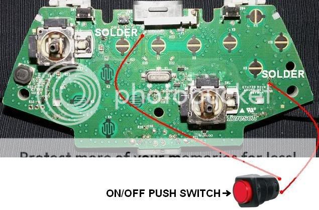

Ok, first off you will need an Old style Wireless board (Pictured Below) - I havent tested on a wired board, if someone has and it works let me know!
Equipment Needed...

Diagram of wiring/ solder points
1) Get your wire (approx 15 cm) and solder one end to one of the points on your switch
2) Get the other wire (approx 7cm) and solder one end to the other point on switch
3) Solder wire 1 to the Left side of Player 1 LED...
yeah, Soldering to the LED is pretty difficult - the way i did it was put a lil bit of solder on the end of the wire, put it against the LED and then melted it with the iron
4) Solder wire 2 to the middle pin of the right Triggers...
Just melt the solder thats already on the board - use extra solder if u need to
5) Test it - If it works, carry on - If not check your wiring
6) Now depending on the size of your button - You need to find a drill piece and place to put the button...
Mine was pretty big and had to remove one rumble motor and drilled where it was placed (pictured below)
7)Glue it in place and your done!

I still dont exactly get where to solder on the led ground, i keep seeing pictures, but with just circles around the location to solder. Can someone give me the EXACT spot of where to solder onto the led?? Im about to do this and i dont want to screw up.
Re: Rapid Fire method (No chip) Easy/ Detailed Tutorial
« Reply #21 on: August 14, 2008, 07:05:47 PM »
Ill see what i can doo...
Ill like zoom in right and put a dot where u have to solder will that work if its zoomed in...
