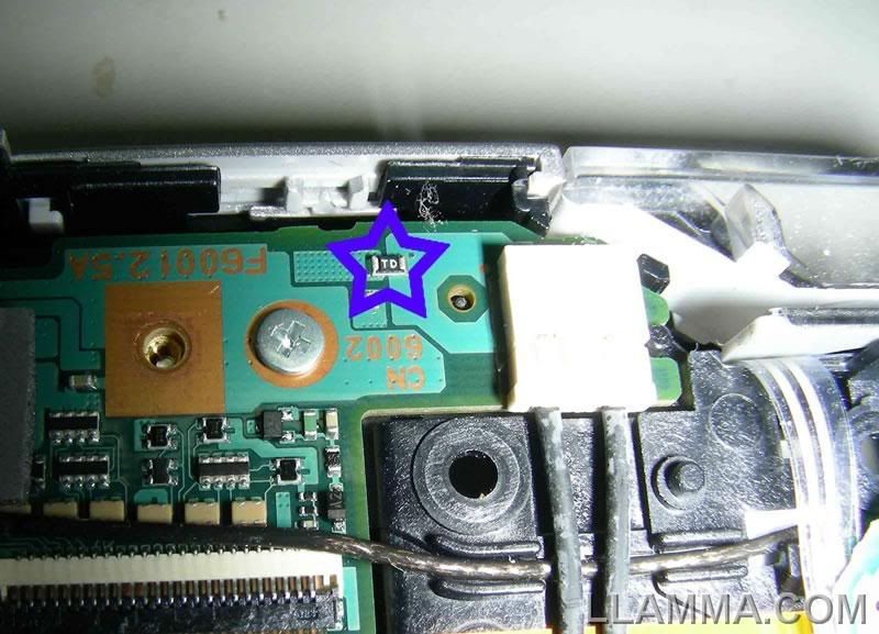

Re: Is My Motherboard Goosed???
« Reply #8 on: August 20, 2008, 08:17:03 AM »
Considering you probably don't have anything to lose, try bridging the power fuse. Hold on, I'll see if I can find the picture for you.
Oh, and for future reference please do not double post, use the edit button on the bottom right of your post. Thank you.
*edit*
Ok, here's the picture of the power fuse.
Just solder a wire from one end of it to the other end, or put a blob of solder over it connecting 1 side to the other side.
Post back if that works.
« Last Edit: August 20, 2008, 08:23:02 AM by PspKicks316 »

nah never worked mate but thanks for the input,ive tride bridging most of the parts lol but they just dont seem to work lol
