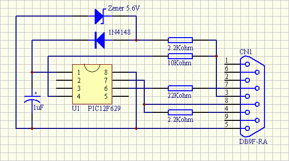

this works on desktops only ill make a simple one for laptop also, this works great for PIC 12F, 16F series
ive been using one i built like this for 1yr now no problems
replace the 22k resistor with a 2.2k resistor, and replace the 1uf cap with a 10 uf cap.
« Last Edit: August 27, 2008, 07:16:02 PM by gameroms »

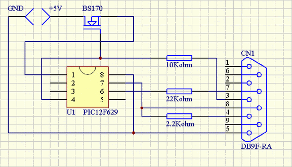

here is the usb powered version, i will also post a radio shack parts list with this one.
« Last Edit: August 27, 2008, 06:57:23 PM by gameroms »

RADIO SHACK PARTS LIST
1 -- 276-565 -- 5.1V ZENER DIODE -- $1.39 -- QTY 3
1 -- 276-1122 -- 1N4148 SWITCHING DIODE -- $1.49 -- QTY 5
2 -- 272-1025  -- 10UF CAP -- $1.19 -- QTY 1
1 -- 271-1325  -- 2.2K OHM RESISTOR -- $0.99 -- QTY 5
1 -- 271-1335  -- 10K OHM RESISTOR -- $0.99 -- QTY 5
1 -- 271-1339  -- 22K OHM RESISTOR -- $0.99 -- QTY 5
1 -- 276-1995  -- 8-PIN SOCKET -- $0.69 -- QTY 2
1 -- 276-148  -- PROJECT BOARD -- $1.99 -- QTY 2
                   TOTAL: $9.72 PLUS TAX
THE ABOVE PARTS LIST DOESNT INCLUDE A DB-9 SERIAL CABLE TO CONNECT TO PCB, YOULL NEED TO CUT IT IN HALF AND YOU CAN MAKE 2 PROGRAMMERS, BECAUSE YOULL HAVE ENOUGH PARTS LEFT OVER TO MAKE A SECOND PROGRAMER.
BUT I PREFER TO ORDER ONE OF THESR FOR $5.99, I HAVE 2 AND THEY WORK GREAT, AND IF YOU MAKE ONE IT WONT LOOK AS GOOD AS THE KIT!   :w00t:
http://www.atvgc.com/shop/details.php?id=10
SORRY ABOUT THE CAPS, DIDNT NOTICE TILL I WAS FINISHED.  and im to lazy to retype..
« Last Edit: August 23, 2008, 08:03:02 PM by gameroms »

yeah i dont see the serial plug that is on the programmer that the cable goes to

« Reply #12 on: August 25, 2008, 05:31:07 PM »
are we supposed to be using a 10uf capacitor or a 1uf? the diagram says 1 but the parts list says 10
Offline gameroms
  • Posts: 376
Re: easiest programer to build!! with schematic, and parts list. Cost $10
« Reply #13 on: August 25, 2008, 06:19:00 PM »
i use a 10uf resistor and i also replace the 20k resistor with 2.2k resistor and it works great

« Reply #15 on: August 25, 2008, 06:51:42 PM »
only usb for power like i listed 2nd diagram
ill look for one.

« Reply #16 on: August 25, 2008, 07:23:21 PM »
So on the second one i can use a DB-9 to USB cable, but not on any of the others? It looks like that one calls for another power source.  What is the GND and 5v parts, another power source?
Offline gameroms
  • Posts: 376
for usb power, add the red and black of usb cable, if your serial port dont put out  evough power
Im sorry, i didnt understand that. This is just usb powered? so i cant program through usb?
Can i do the first one using this?

« Reply #27 on: August 29, 2008, 08:50:48 AM »
ive never needed it,
just be sure to replace the 22h resistor with 2.2, and replace the 1uf cap with a 10uf cap.

« Reply #28 on: September 22, 2008, 02:08:52 PM »
what would this programmer be called? is it a jdm?
Offline gameroms
  • Posts: 376
« Reply #29 on: September 22, 2008, 09:55:18 PM »
yes, thats a jdm.
