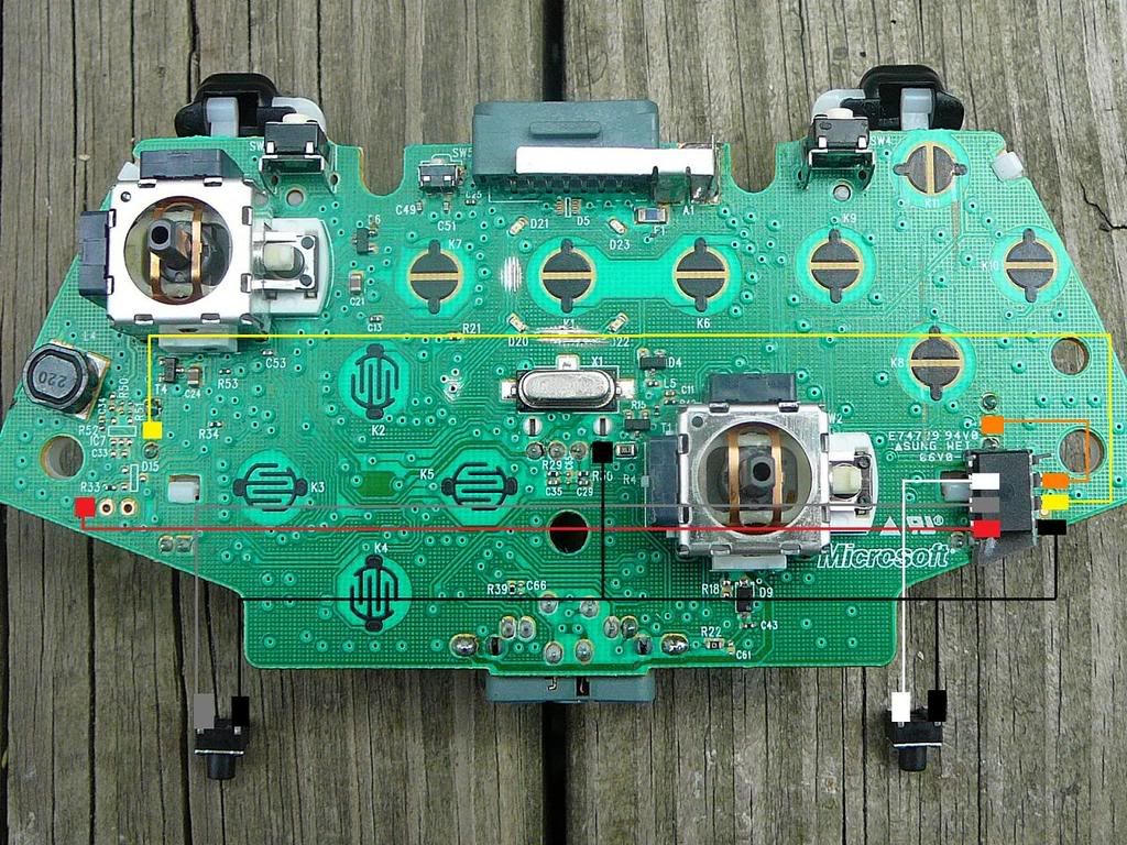

Offline gameroms
  • Posts: 376
Re: Contact came off
« Reply #7 on: September 04, 2008, 07:26:23 PM »
your on 600 F, cut that down to 400F if not lower,  also if you use rechargeable batteries you shouldnt need that point.

Offline ChevyRacing09
« Reply #11 on: September 05, 2008, 01:40:41 PM »
use the gnd point in this, it will work fine
