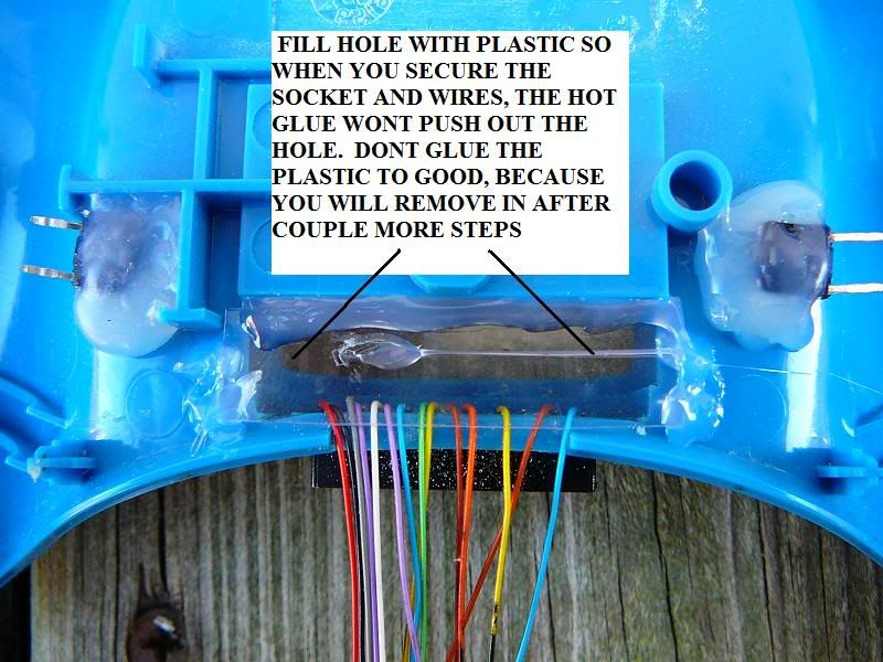

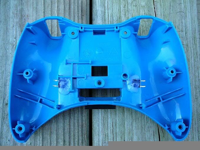

will have dual rapid fire, rapid reload, hold zoom/breath, 3 led indicators(1-rapid reload on/off, 1 for each of dual rapid fire), and possibly a few other secret features.
this will be for rechargeable packs only, the AA battery contacts are removed to make room for the socket on the bottom.
to get the holes straight in the controller fot the socket legs to go thru, i removed the legs from the socket, then hot glued the socket where i wanted it, and used the socket to drill my pattern. works perfect.
UPDATE 11-3
For the next step you will need a couple things, pictured below.  Use your favorite lube on the bottom half of the battery to prevent the hot glue from sticking.
Before i clean up the hot glue and remove plastic.
