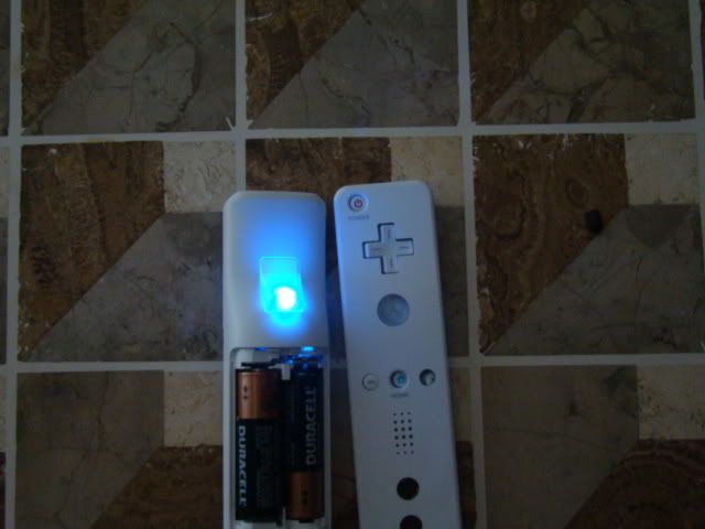

We love having a activation led to let us know what mode we are in....

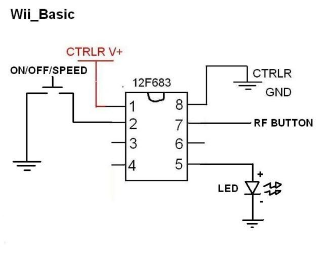

Wii Wire Diagram.

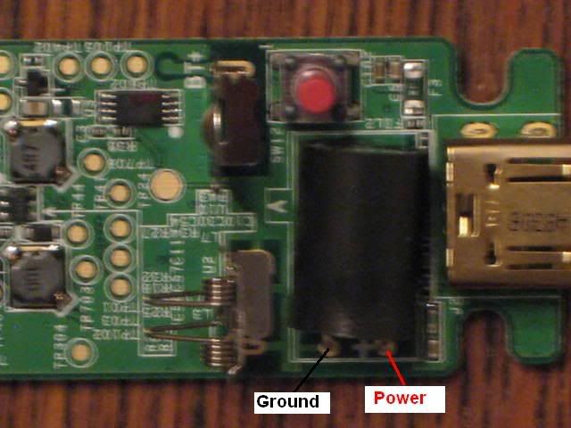

+V and GND locations.
B location on pcb is Lable you can hook it up to the pads it self if its hard to solder to the B point
Yellow wire solidered to B location on pcb.

yeah you can keep it simple .. we even made the basic simpler .. remove 10K not needed any more ..
IF you don't Want the LED than Just Leave Out Pin 5 .. thats it .. only 4 pin to wire up .. there only 2 mod any way
is not hard to tell which is Which
Your first diagram showed a switched ground going to pin 4 but in the new diagram it was moved to pin 2 and nothing on 4?
Don't worry about pins moving around, these are microcontrollers that can be configured anyway the programmer desires.  Some pins have additional functions, so not every pin can do the same job, but for the most part all the pins can be used as inputs and outputs.
I think you may be looking at this like a chip with a special funtion like a 555, it is not.  It is more similar a computer in that it can be set up in many different configurations, with endless amounts of functions through custom firmware programs that are loaded to the chip.
Hope that clears it up for you, and don't worry about being a bother....there is no such thing as stupid questions, just stupid answers :winker:

What I meant by my question is that you stated "only 4 pin to wire up" but your new diagram has no 4.  I just wanted to make sure you meant pin 2.

I think by "4 pin to wire up" Mike means that you only have four wires to solder for the entire install.

the black and and Red is the + and - for the 603 SMD led ..  that thing at the end is the led pre solder for you
there is also another one that is not solder its a extra one .. in your kit
why they are 2 switches .. 2 color red /black pick one what ever you like there is no wrong answer

Now there are 2 ver of the Wii Remote Board and some one email me the picture of the new
board i have mark the points since its Diff that the one i did the TUT on :
