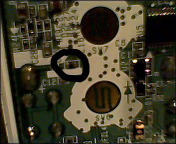

hey, i opened my wiimote today to add an led on the A and B buttons today and tey works :tup:, put the  wiimote back-together and it was still working.. then i left it on my desk, went out and came back to find it in bits... i asked everyone in my family about it and noone admited it and now the remote doesnt work... when i press a button the 4 lights at the bottom dont flash. what could have caused this?? i can get pics if you need?

It shorted out, you'll need to bridge the fuse that's to the left-middle of the 1 and 2 buttons. Should be perfectly fine afterwards, but if it shorts again then I'm fairly sure you're screwed.

how do i bridge the fuse? and where abouts is it?

That's what I have bridged on my clear led modded wiimote.
Just solder a wire from one side to the other.

dude i bridged that fuse and only 1 led at the bottom of the controller is flashing is that normal? or is the remote  :censored:?
EDIT: can i put hot glue over the fuse as my soldering is bad atm?
That's your battery level. The number of leds that light up depend on the batteries.
0-25% is 1 led, 26-50% is 2 leds, 51-75% is 3 leds, and 76-100% is 4 leds. Of course, it's an approximation.
Hot glue won't bridge it. Put new batteries in and test it out, I'm sure it will be fine. If not, hey at least you have a working controller again now.

no i ment could i put hot glue over the wires that are soldered to the fuse so it doesnt come unsoldered..if you get what i mean?
Yeah that's a good idea. I thought you meant to bridge it.

cheers kicks my wiimote is fixed now and i got 2 pics to show you guys my mod...
