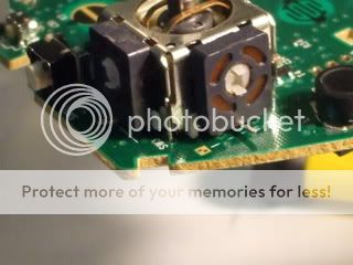

you dont have to completly remove the anolog just the pots, remove them and bend up the center pin:
put them back in place with center pin bent up so you can get to it later, and replace the trigger"

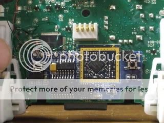

early test:
final placement:

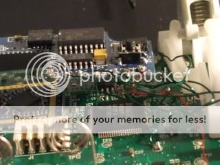

preprapid fire socket:
program pic:
final fit and install:

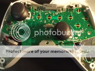

finished front:
finished back:

if any one is going to do this, you can follow the directions from talismoon, however, when it tells you to put the trigger back on, that is the wrong step, if you do so, you will not be able to get to the existing solder point for the canter pin of the Y pot. you must solder a leed onto the hole where the center pin of the top pot was, and then put the trigger back on, I learned this the hard way.
