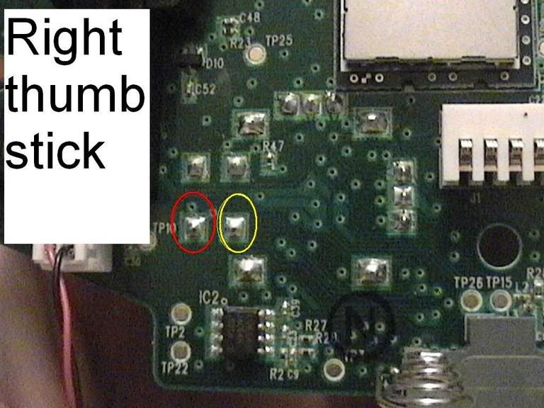

I am not sure why but I always have trouble clicking down the thumb sticks and keeping the stick center. is there a way I could mod my controller to place a button underneith like where people put thier rapid fire buttons that reproduce the click down on the thumb?
I know how to solder and stuff, just not sure the schematical layout of the thumb controller, like which contacts connect when you push it down. any help would be great!!!

if you want to make a button to click for the left stick
you need to remove the left trigger and directly underneath the button are the four pins for its tact switch
for right stick its easy just do the same but without removing the trigger of course.

these are accessable without pulling the trigger, if you got skills LOL

no need to pull trigger (might be easier). you can always tack wires to the spots he shows in the pics, or on the switches themselves on the other side of the board.
