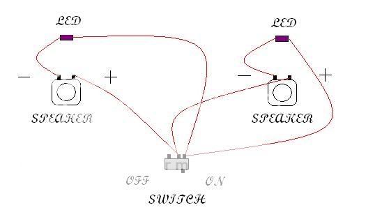

YES, you can put swith for your mod.. so you can turn it off if you dont need it..
this is a diagram for a direct reactive leds without sound chip (LM386).
just buy a switch, like the WIFI switch... and you can put it here for easy access...
like this one on the pics..
I don't see a switch in that pic..
Also you don't need to wire to both speakers only 1.

the switch is below the MEMORY CARD cover.. the Blue thing,
i use this diagram so the leds will not share power for one speaker.. so each leds will get independent supply of power from each speaker.. idk

« Reply #13 on: March 12, 2009, 05:36:04 PM »
it wont affect it much if wired in parallel.
ow... so it will not affact much.. T_T
that diagram i use fry my sound fuse.. to bad for me..
