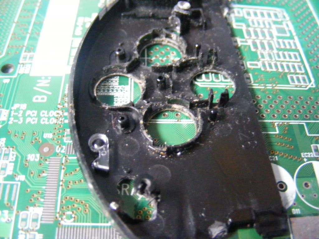

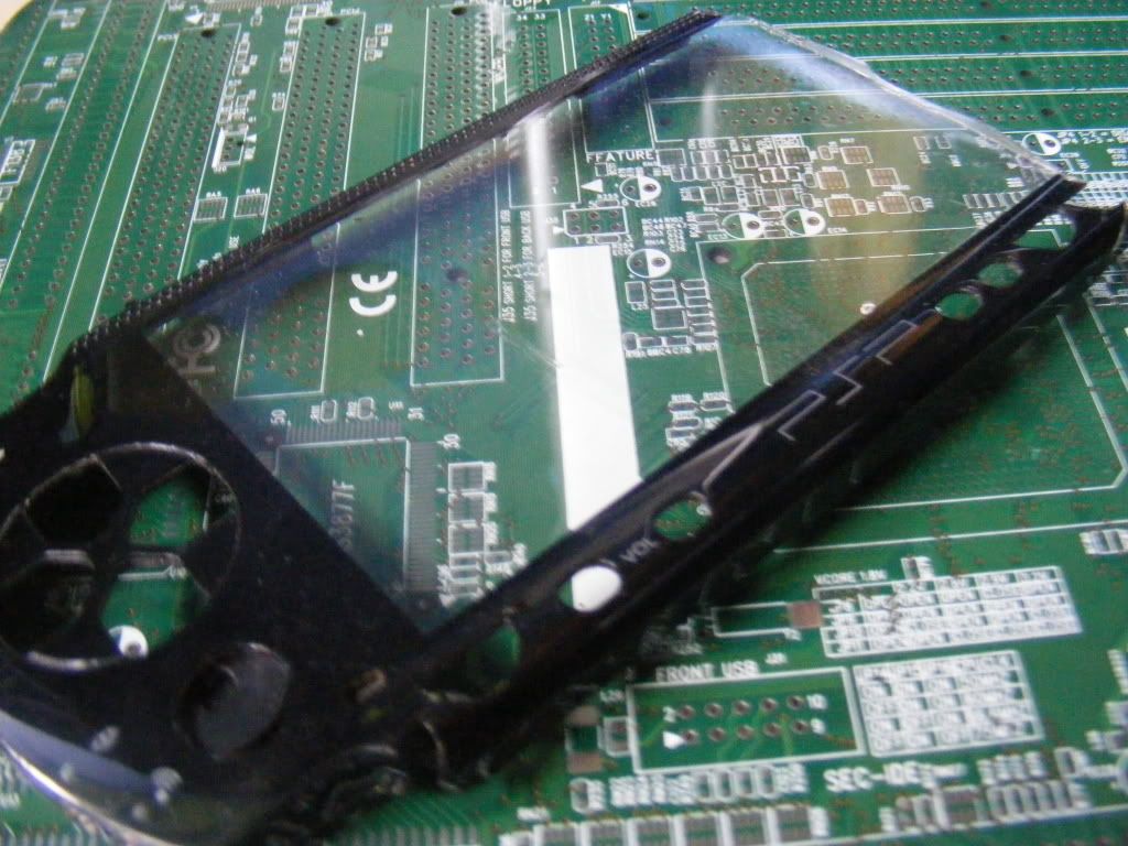

I had this problem a while ago, annoyingly. Bought a PSP off the internet, ready for modding, and two faceplate screws were stripped. In the end, I had tried to free it and it had snapped, so that just the area to the right of the PSP stayed on.
  So, what I did was get a spare PSP faceplate and a pair of tweezers (yes, odd :)), and then put the PSP in  between the tweezers and located the where the screw holes would be in relation to the faceplate, as the tweezers would be in the same position either side. Then, on the part of faceplate that was still on, I made some marks with a crafting knife as to where the screw holes would be, got the drill out, and drilled right in. Surprisingly, it worked and the screws just dropped out. By the way, this would be even more sacrificing that faceplate of yours.  :boxed:
  If you carefully try that out, it should actually work.
Here are some photos of the PSP faceplate that I used:
