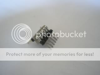

alein you said you would teach me, you told me what I needed, ic headers, dip socket, veroboard. Then I had to work it out myself.
after hours of searching the internet through info that contradicts itself, I finaly found everything I needed.
Here is the info I used to make mine:
this is what I got, ages finding info 3mins to build (I wasn't going to waste my loved 8pin sockets was I)
I belive this is the best way, only 2 jumper wires to be soldered to the board. Scratch on left hand side of ic headers, lines up with the arrow on the pic kit
Lol, that must be a world record! What info contradicts itself? It is just a 5 second search for "pickit2 pinout" and then a quick look at the respective PICs datasheet and that's it. Or if you were really struggling, there is one on instructables.
Just to clarify something about my adapter, I built it that way since I use the ICSP feature when developing code on my breadboard, since you guys don't do that then an adapter like I built probably isn't the best choice, however you can still standalone program them on a breadboard. Maybe you are better off getting a JDM or something.
