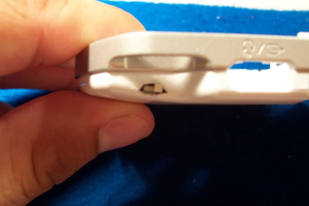

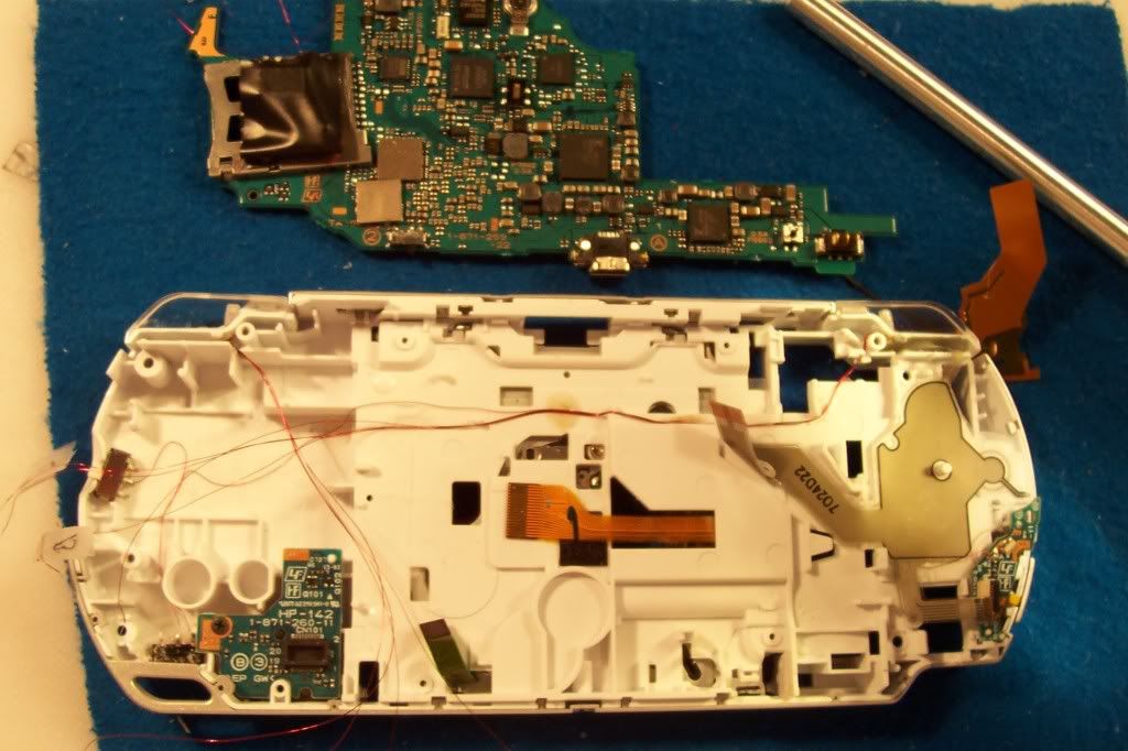

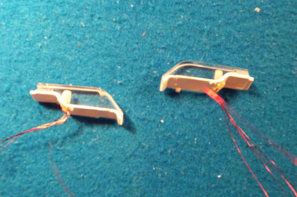

Hey guys i got this mod i been working on for like 3 weeks i had issues with the solid not coming up. This isnt my slim its one of my customers. Heres some pics and video. Tell me what you think.
This is the the diagram of this and its proven to work i had to edit several times cuz of the solid.

Magnet wire seemed to work quite well for you. How do you go about stripping the enamel coating off of it? I've read you just use the heat from the soldering iron. Is that right?
Re: Blue and Purple SR/Solid Slim Mod(Pic/Vid)
« Reply #4 on: April 17, 2009, 08:16:11 PM »
thanks, it went off to one of my customers from youtube. yea you first dup lil flux on the tip of the wire and use a blob of solder to melt the enamel off. its not hard at all.

tahnks bustin umm no i actually made that my self home made.

dude, nice wiring! I going to put a switch where you put one(under the trim loop thing
Thanks for giying me the idea where to put a switch!

Well first off, for the tenth time, very nice job.  But I have a few Q's if you got a sec.  Did you say that was the dremel drill press add on?  Cause i have a dremel and if thats what you used, looks like a good investment.  Also I heard magnet wire wasn't a good idea did you have any probs with it.  What gauge did you use cause it looked so small?  Did you use something different for the ground and power?  Sorry for all the questions, just always lookin for a quicker, smarter, better way to do things.  Thanks,

Ryan, I can answer one of your questions! He used magnet enamel wire.
« Reply #24 on: May 03, 2009, 06:34:20 PM »
                                                    ryan aka crzywitboy3
Yeah I do think he had a dremel drill-press add on. Magnet wire is supposedly easier to short and stuff, but it seems to work for him. For the magnet wire gauge, looks about 30. And for the ground and power, I'm not sure.

Ok yes that is a dremel press you can get this at home depot or lowes under 50 bucks works very well in drilling stuff and easier to sand as well since you can use both your hands to hold the object. The wire isnt 30 gauge it is 38 gauge its really really small but it works fine for me but i would suggest if you havent had much experience to go with 30 gauge as a start. Also i may have pointed this out below before about how to remove the enamel from the magnetic wire ill say it again. You simple dip or scrap lil piece of flux place it on the tip if the wire and take a blob of solder and simple let the tip of the wire sit in the blob it will smoke some from the fluz and youll start to see a dark liguid appear in your blob of solder. Thats the enamel being removed from the wire so pretty much have tined that wire and its ready to solder on. For the ground i used the wifi switch and the power i used the 5v point on the mobo for both sound reactive and solid. The digram below should help you out.

Thank you all very much for the answers.  The only thing is when I asked about the power and ground I ment what kind of wire did you use because I was told that if you have more than 4 leds in parrallel that you should use at least 26 awg to handle the current.  But thanks again everyone.
                                                             crzywitboy3
Nah you can handle up to like 10 + 0603's with 30 AWG kynar wire which is what I use.

Dude this was the only thing I could find, is this what you used?
http://www.homedepot.com/webapp/wcs/stores/servlet/ProductDisplay?storeId=10051&langId=-1&catalogId=10053&productId=100609334&N=10000003+90401
No that not the one heres a pic of the one i used.
                                                             crzywitboy3
No dnt use 26 to big 30 is your best shot go with that.
