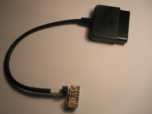

Cut off the end of the extension lead and wire it into some headers so you can use it with your breadboard:
Blizzrads:
Mine:
I have been working on  this project, and I am sure Blizzrad has, however as Blizzrad mentioned earlier, he doesn't want everyone depending on him as per Gr8npwrfls thread. The best way for you to do this is to start learning about microcontrollers, devote a couple of hours a day or something like that to researching and learning about them on google.
Blizzrad did also mention that he had all of the hardware pretty much done, it was just a matter of tweaking the software on the PSP side of things..

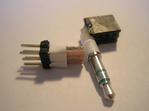

I don't understand your second question, here is an adapter that I fabricated for the SIO port:

The reason there is a header on the SIO is so that it can be used in a breadboard!

Nice find, old extension cables are definitely the cheapest and easiest source for prototyping connectors that I know of.
I would like to make it very clear again that the PSP software required for this to be useful does not yet exist. Unless you are interested in microcontroller/PSP software development, there isn't much reason to assemble the circuit at this time.
That being said, for this circuit whether you prefer a breadboard or point-to-point soldering is just a matter of preference. With microcontroller stuff, I usually prefer to work with a breadboard and make easily removable adapters for all cables and connectors. I do this with pin headers, perfboard, and zip ties like in the pictures that Alien posted above. This makes it much easier to change pin configurations while prototyping, (something you may end up doing a lot as you develop code). Male and female pin headers can be found very cheap on ebay if you don't mind buying them in larger quantities. For the SIO connector, you could cut one off a remote or build your own, just so long as the required pins are making contact.
