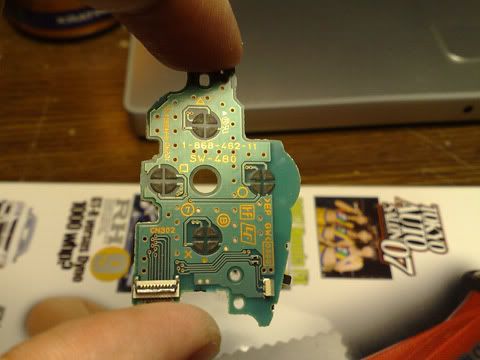

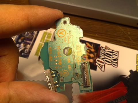

I took some pics (with the button board problem) with my N95 5MP  :tup:
Pictures ahead
NON-WORKING Button Board PSP VS WORKING
not working button board PSP
NON-WORKING Actual Button (ABXY) Board VS. WORKING
broke front
broke back  (mountain)  :laughing:
working front
working back
As for the button ribbon cables, gonna switch it up now to see what happens.
 But let me know if you see anything !!  :greedy:

from what i see the one has a broke switch other than that, everything seems intact. i wish i had a extra, i would send it to you. i hope you get this working.
Thanks man, after hours spent switching various boards left and right,  i FINALLY got everything working again!!....Almost  :eyebrow:

yeah just from the pics you posted above, you can tell the lobos do not match. The bottom one is like the one I have. It doesn't have the gray crap up by the USB and in the center. It instead has a small spring-loaded contact point.
You need a new wifi board that will match your motherboard.
