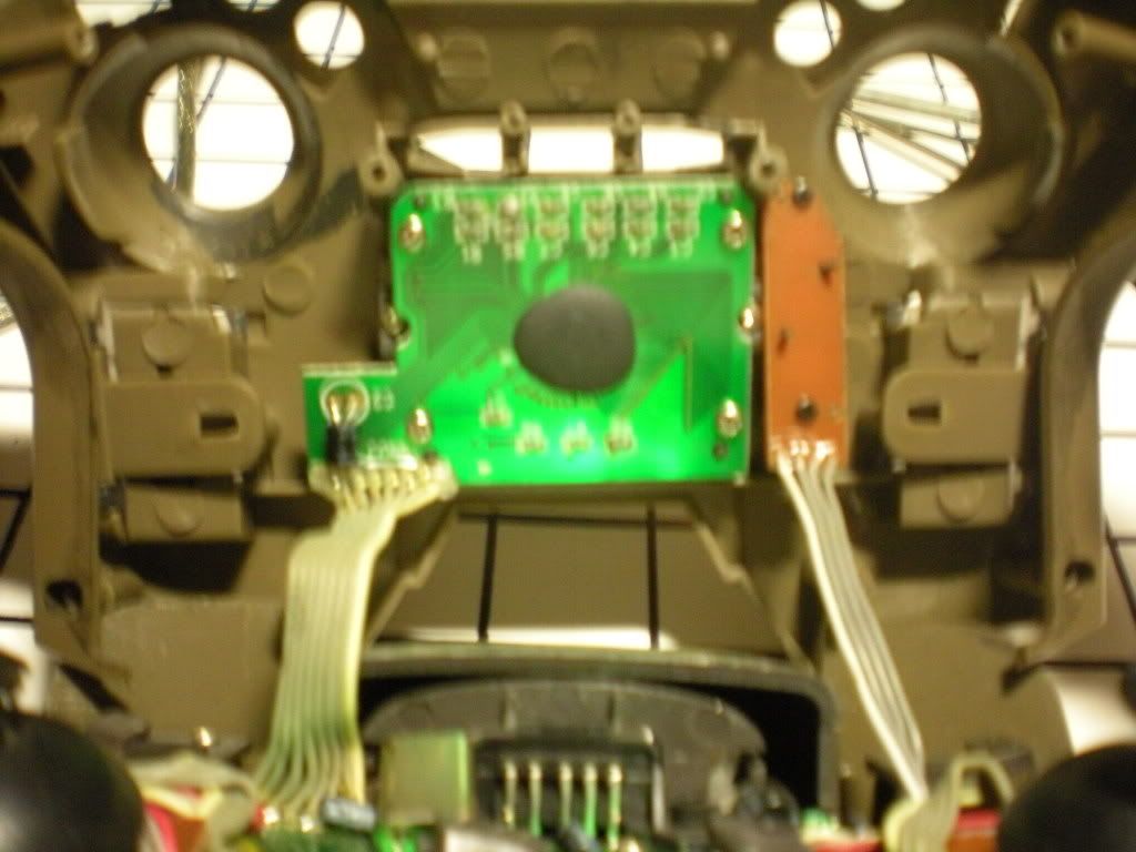

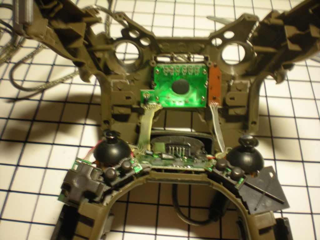

I have taken pics of the inside of the FPS controller, I will need to know what I can remove and what controller would be best to use (suggestions?) I want to use a official xbox 360 corded controller.
And now the pics, the grid that you see behind it consists of 1 in. squares.
BE WARNED!!! THEY ARE MONDO HUGE, AND MY CAPS LOCK IS STUCK!
I can get more if you request them, esp. of certain areas. Also that is about as far as I got, I afraid to take it apart further.
The controller
Opened up
Inside
Inside top
Useless screen and buttton panel.

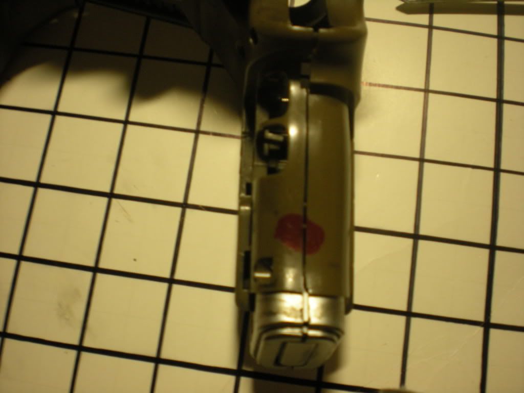

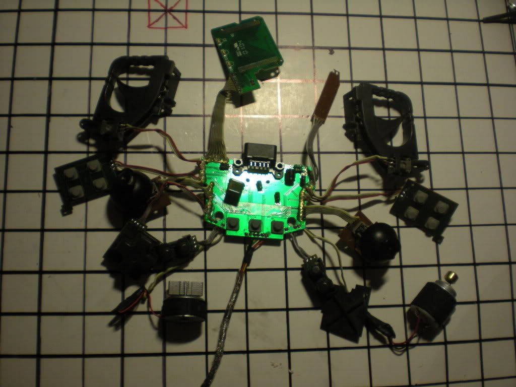

The insides taken out!:
Also: I plan on not having the rumble feature, instead I will be placing the LB/RB in its place. And maybe instead leds light up.
LB/RB to go on red dot( one on each side)

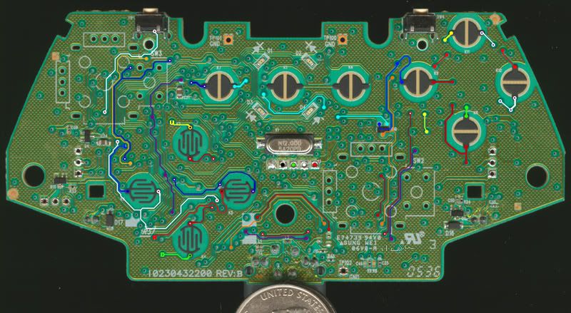

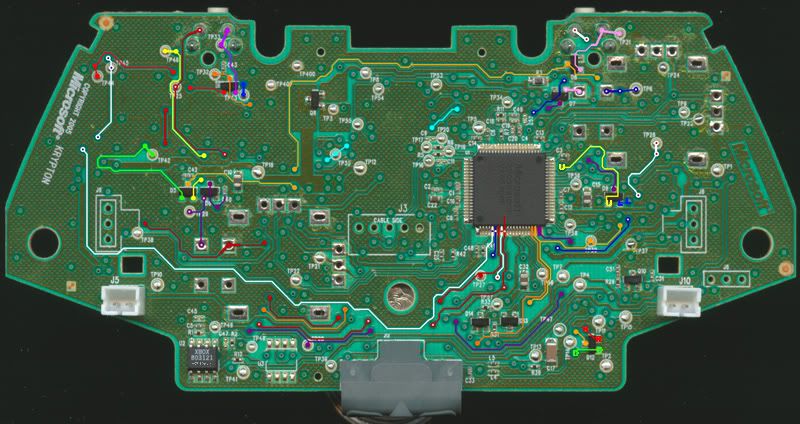

remember the controller you use pretty much has to be a CG for this mod. Here is how you can tell:
Identifying CG or Matrix
Offline scott
  • U.S. Army
  • Posts: 208
Re: Really costom controller. *help needed* **update**
« Reply #7 on: September 03, 2009, 12:50:08 PM »
I have (or had) one of those controllers for Halo2.
Its a beast and amazing.
Figure out which controller you are using (360 wise) pin out the original box controller, and simply connect its buttons to the button spots on the 360 controllers mobo
http://forums.xbox-scene.com/index.php?showtopic=581799
Credit to RDC for pictures
WIRED MATRIX DIAGRAM
WIRED MATRIX TOP
WIRED MATRIX BOTTOM
http://forums.xbox-scene.com/index.php?showtopic=581887
WIRELESS MATRIX DIAGRAM
WIRELESS MATRIX TOP
WIRELESS MATRIX BOTTOM
« Last Edit: September 04, 2009, 03:52:37 PM by 802Chives »
