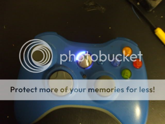

OK... i do not play or even own COD, I  am only a halo3 player. So i tired the other open source codes in this forum. They work well.. but, in halo3 you pick up a spartan laser and have a warthog or banshee coming at you, you need to turn off the mod to fire it. It got to be a big pain in the a$$ to cycle through the modes to get it to turn off. So i made my own :) I wrote the code in Proton+ Pic Basic.
I will post it here. I would like someone to test it for me to help me tweek it.
Rev1.0: This is for a Matrix controller (i dont have a CG) in SLEEPER mode. It currently only has right trigger firing (its really all you need).
You press the sync button to turn the RF ON or OFF. Its a single mod... no other modes for other speeds! This is designed and intended for Halo3. Installation is the same as other sleeper chips, use 12f683.
Click to enlarge.
Download the TXT file from the attachments below and rename it to HEX!

UMM, why should i use the "gameplay RF" code? I wrote this code myself. From scratch. So, i will give myself full credit :). The intent was a Halo3 ONLY sleeper mod chip... so you can quickly turn on and off the RF.
I did borrowed the image from google images. If any one wants to claim rights to the image, please step froward, and i will be happy to acknowledge you  :hifive:
